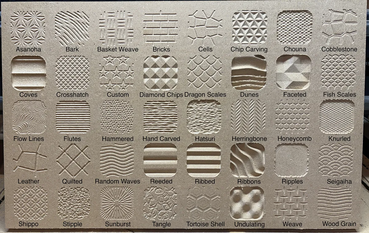

A test carve showing off all of the new pocket textures.

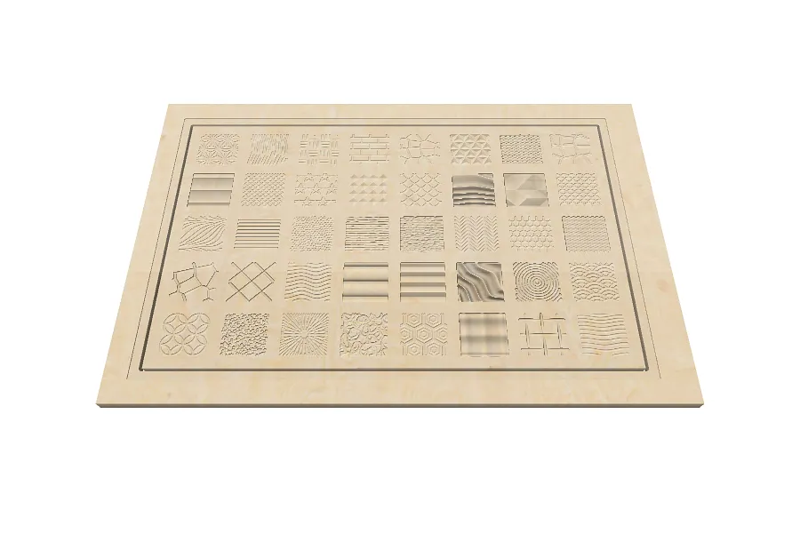

The initial surfacing depth can be adjusted for your setup.

Hi this is great help - would mine sharing what bullnose bit you used - trying to figure out if the Texture patterns use an Uncut Ballnose or a Tapered Ballnose bit ??
Charlie - River's EdgePro · October 25, 2026
I used this bit for the test carve. spetools.com/products/spetool-m03001-stainless-st…
Brian AdlePro · October 26, 2026
I haven't tested the textures with tapered ballnose bits yet but a few users have had success.

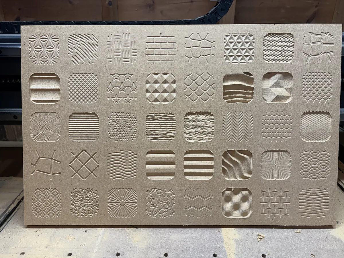

I tested some new V-bit textures over the weekend. The MDF couldn't old onto the knurling but the rest turned out great.
Brian AdlePro · November 09, 2026
It's interesting to see how the textures hold their shape on different types of material.
Zach KaplanPro · November 09, 2026
I agree. I think in metal or plastics the knurled would hold up but with wood grain and especially engineered material like MDF it'll be tricky. Maybe HDF could support it or I've also seen folks suggest using a sanding sealer first to strengthen the MDF.

There was a little bit of blowout on some of the patterns and I think it was a combo of upcut ballnose bit, DPP, and MDF just not being very strong. Couple options for when doing patterns in MDF: - Sanding Sealer before carving to lock in that top layer of fibers - Downcut ballnose bit should improve surface finish - less aggressive cut settings
