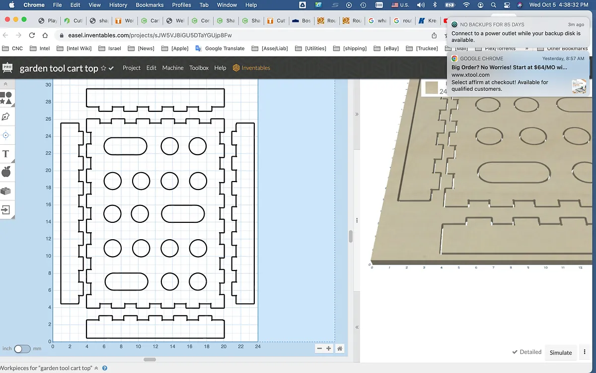

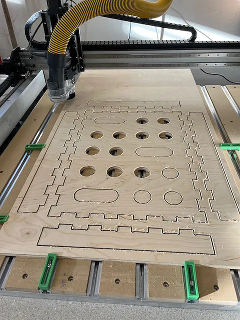

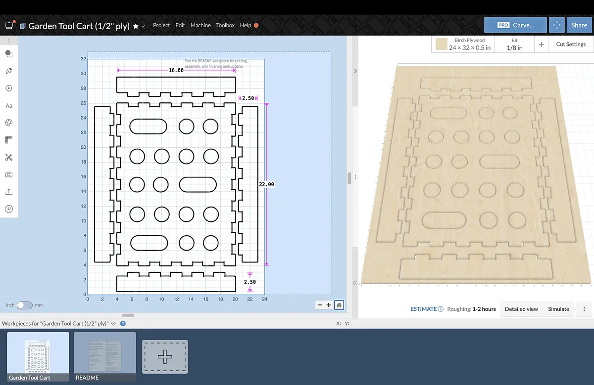

• Cuts from two 24"×32" sheets of 1/2" plywood. • Trays are fully CNC-cut with finger joints; legs are laminated for strength and rigidity. • Sized for rakes, shovels, brooms, and other long-handled tools. • More CNC shop & garden designs available at: https://www.etsy.com/shop/TahoeCNCDesigns
1
Construction Steps

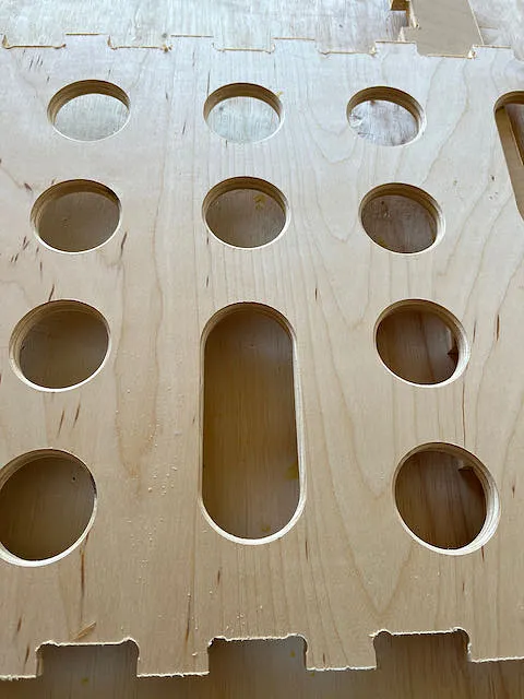

Cut this design file on a 1/2" x 24" x 32" plywood. Sand, ease edges of the cutouts, glue up. This is the top shelf.
Cut this design file again on a 1/2" x 24" x 32" piece. Sand, ease edges again, glue up. Add a solid bottom. This is the bottom shelf.

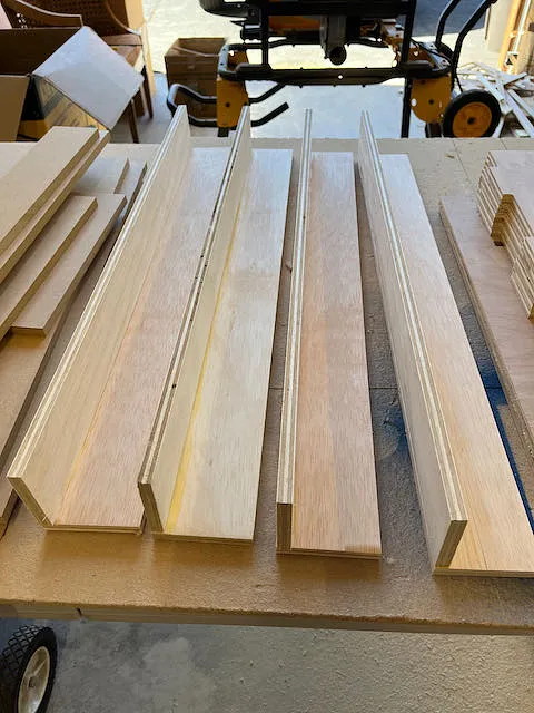

create legs out of four pairs of 3" x 32" and 3.5" x 32" pieces of same 1/2" plywood. glue up.

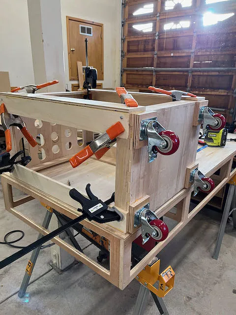

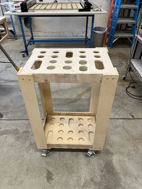

assemble top shelf, legs, and bottom shelf. glue and screw.
add caster plates, glue and screw. add 3" casters. Screw in through caster plates and into bottom shelf.
Estimated time: 60 minutes
