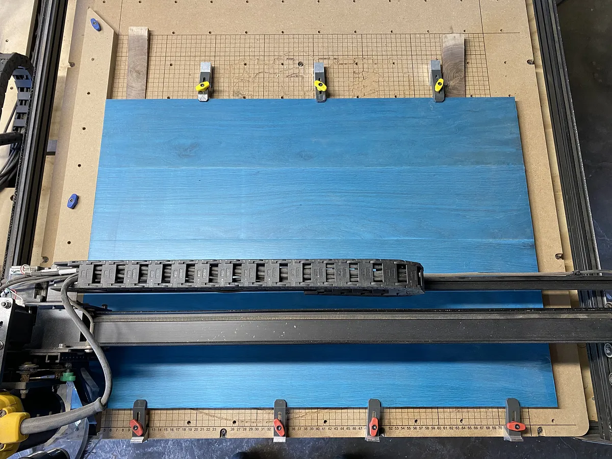

2. Carve "2 Stage Carve"
Rough Pass - 1/8" End Mill Feed Rate: 46.8 in/min Plunge Rate: 9 in/min Depth Per Pass: 0.0625 in
Detail Bit - 60 Degree V-Bit Feed Rate: 52 in/min Plunge Rate: 9 in/min Depth Per Pass: 0.0625 in
Estimated time: 480 minutes

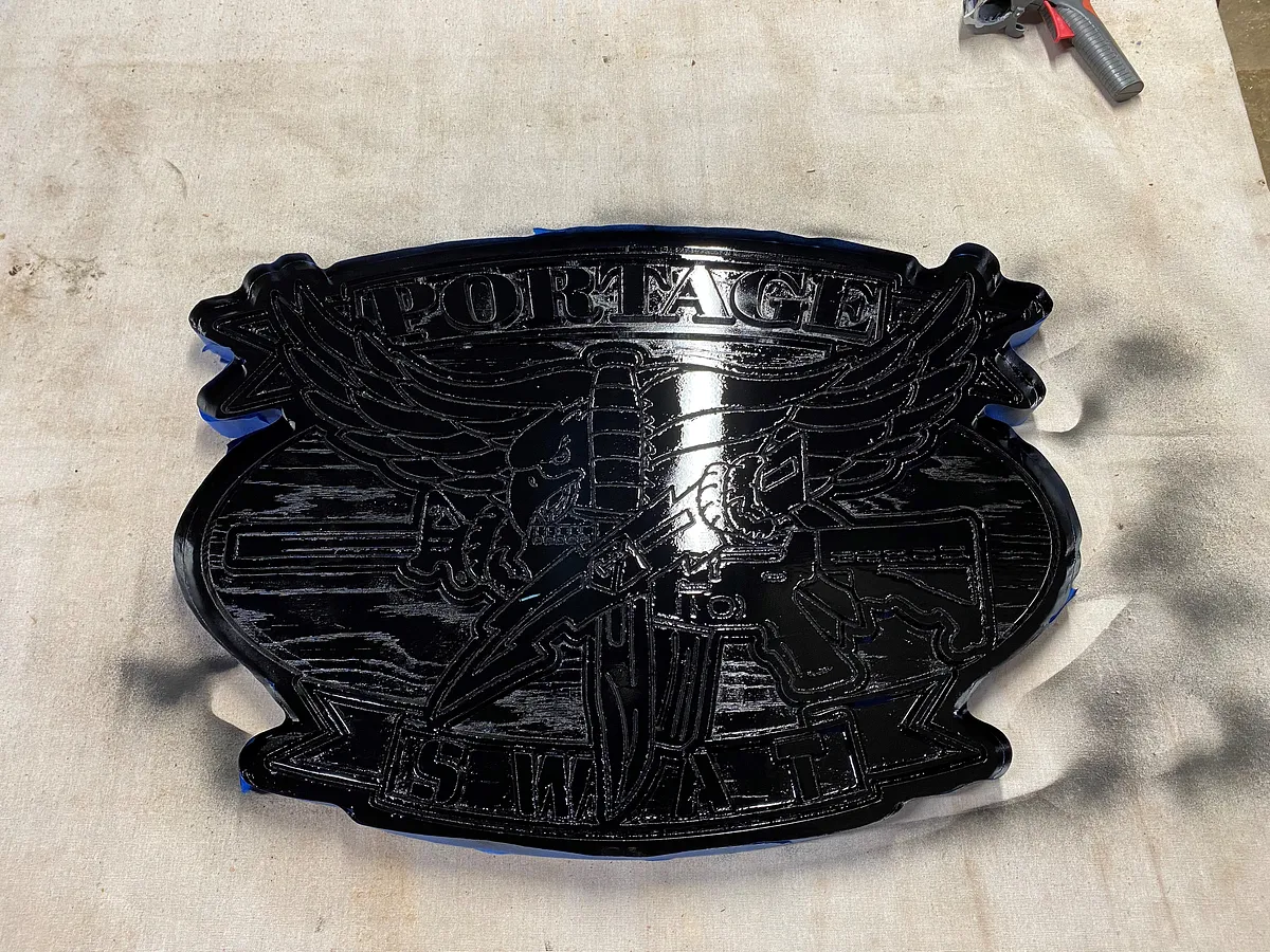

1 - 2 coats of spray paint:
I use the following: Rust Oleum - 2x Ultra Cover - Paint & Primer - Satin Canyon Black
Estimated time: 15 minutes

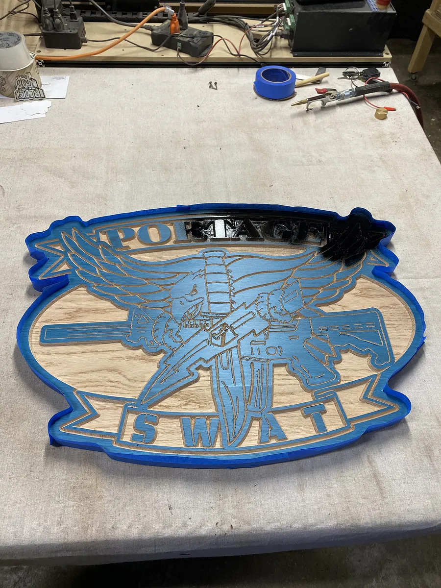

9. Peel off Oramask
Peal off Oramask (using small Exacto knife if needed.)

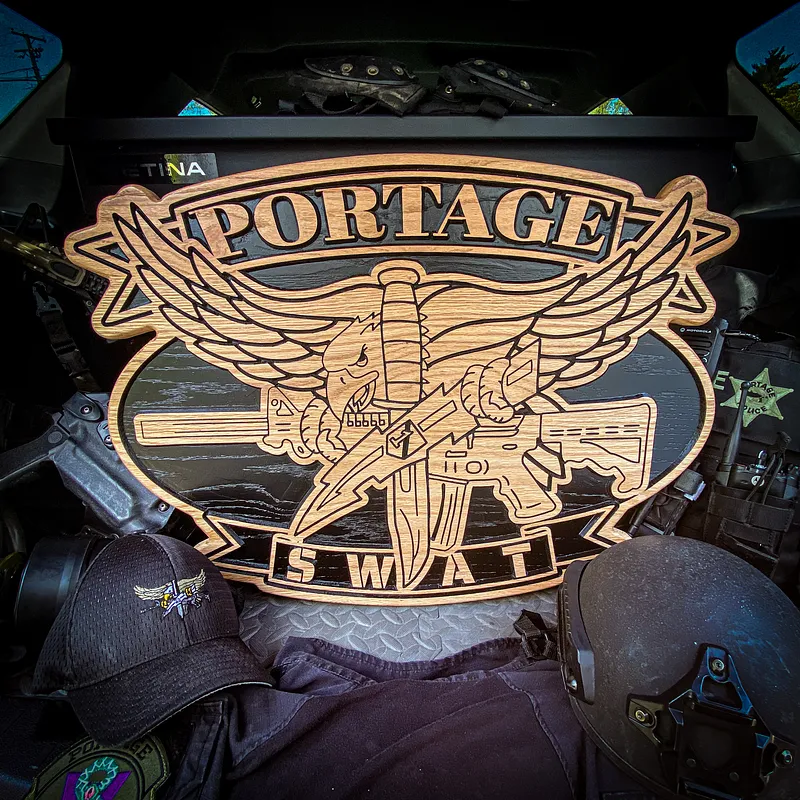

13. FINISHED!
Let dry and you are done!
