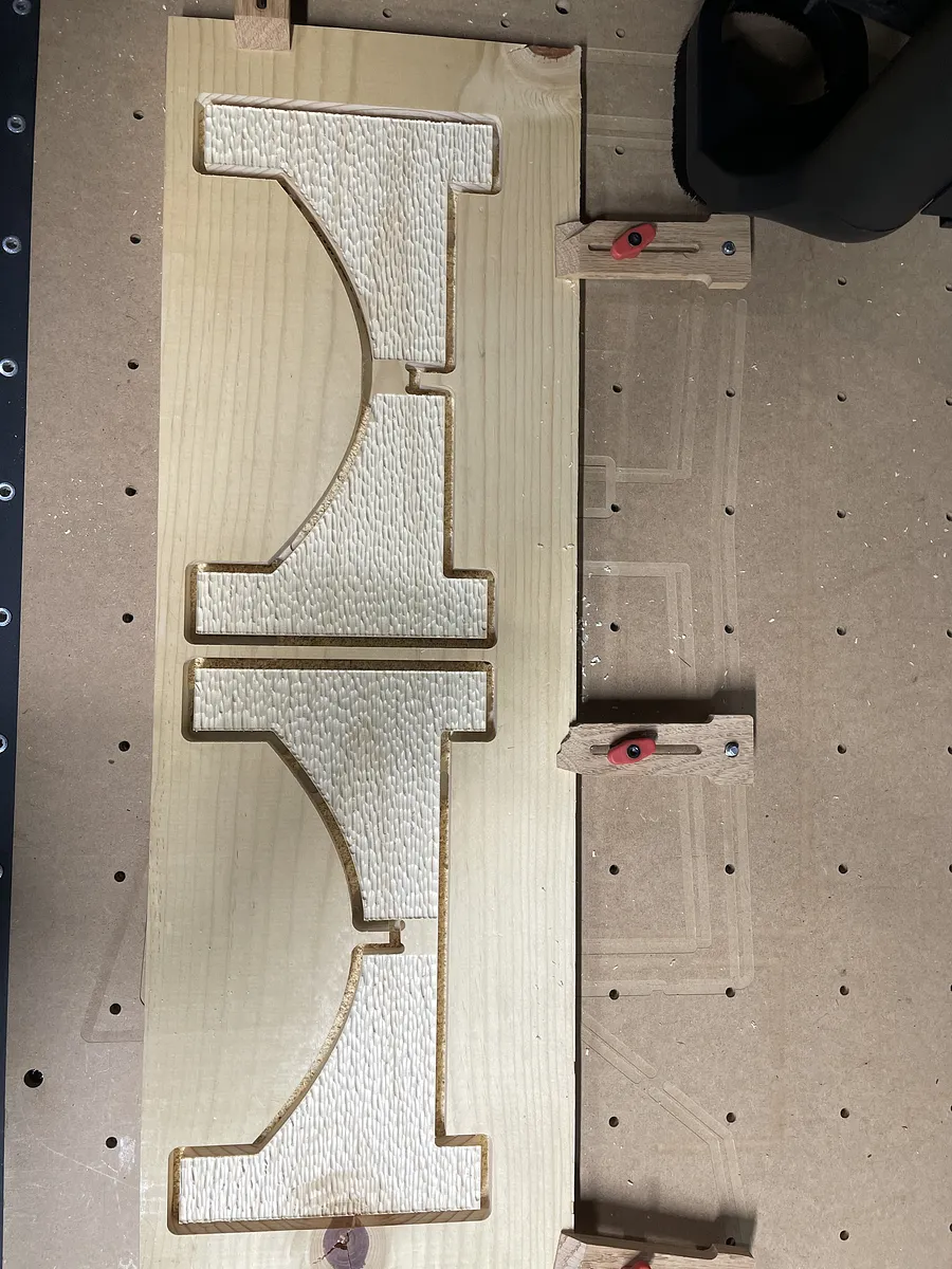

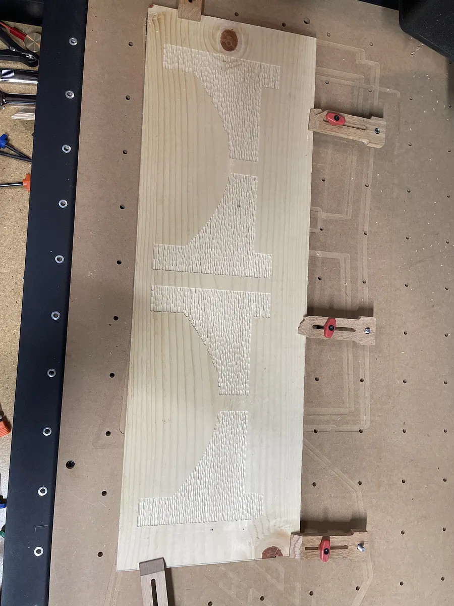

I used a tapered ballnose for the texturing, started it at the default feedrate and then bumped it up by 10%—but it probably could have gone even faster.

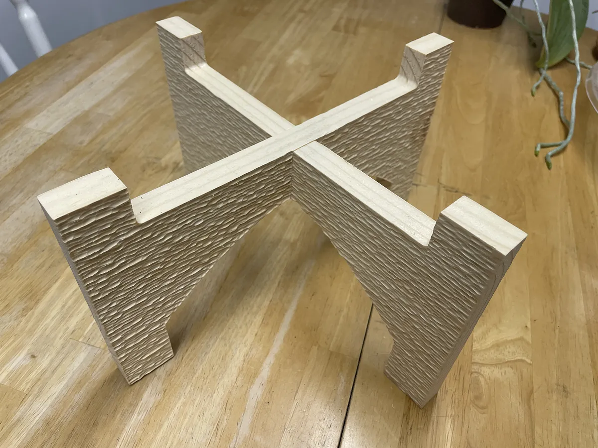

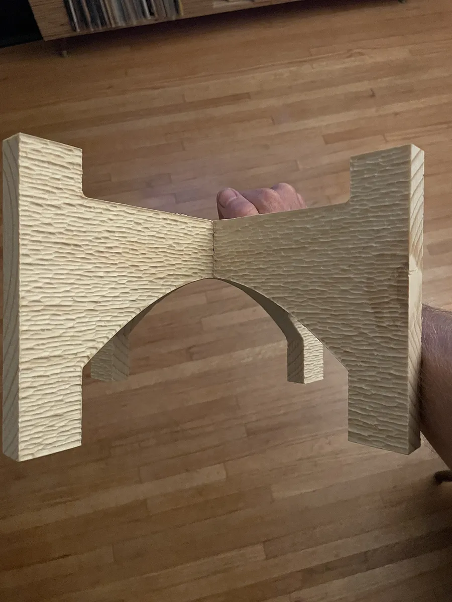

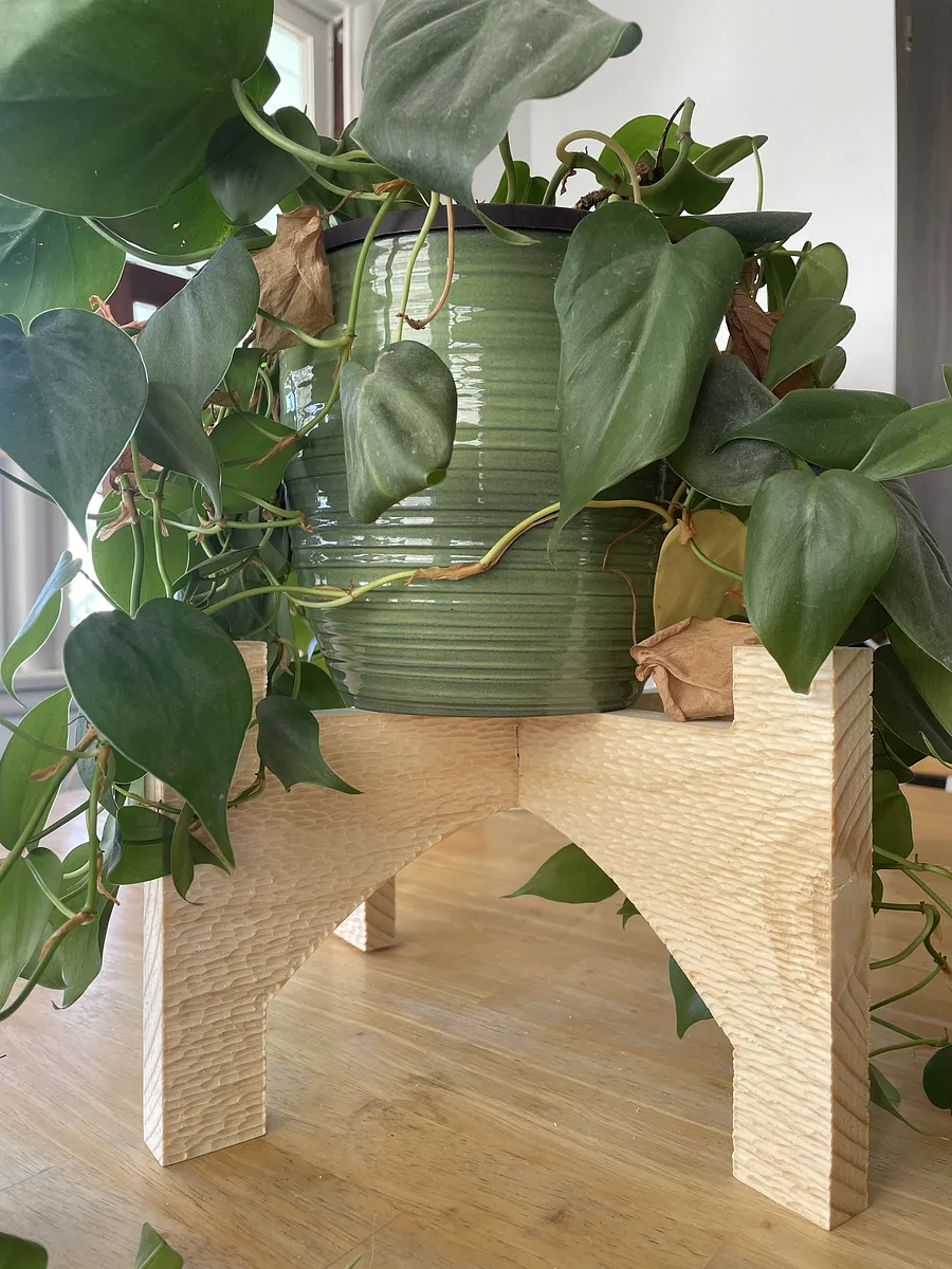

This was my first idea of something to do with the new texturing feature. It's also my first successful flip-milled design! Since the flip is between two texturing passes, the very slight registration differences aren't as noticeable in the final product. The pine was mostly a test though I'm pretty happy with how it came out. I'll still probably redo it in hard wood.
