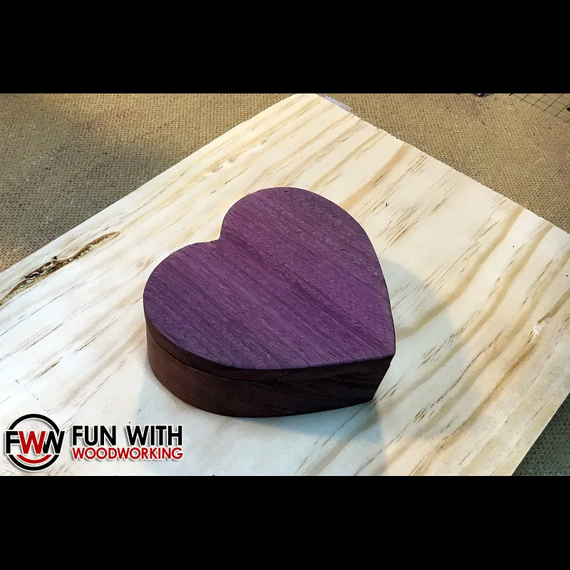

Open the project in Easel and scale to fit your material. I made mine out of 1 3/4" Purple Heart.

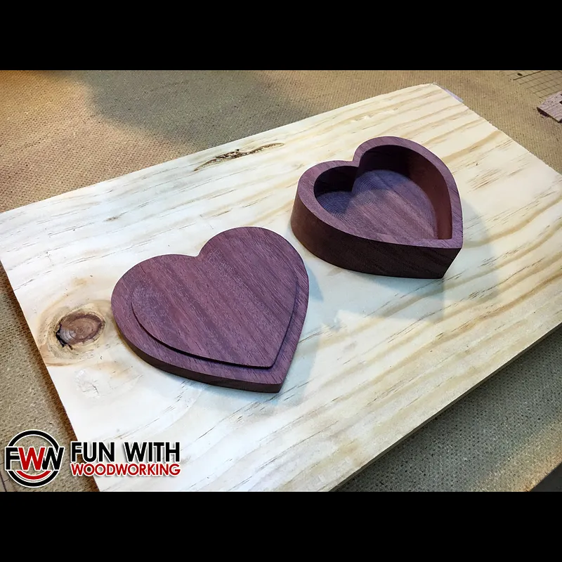

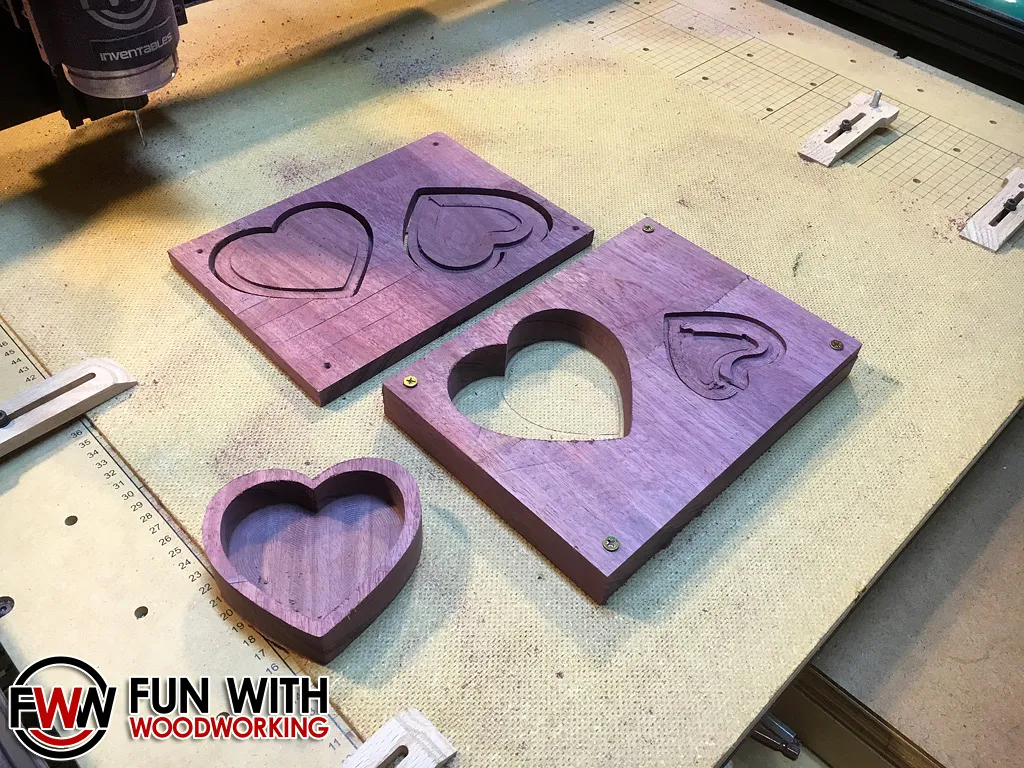

Cut out shapes
I used an 1/8" upcut spiral bit but the design should accommodate a 1/4" bit with no problems. I have one on order and will test it out when I get it and update this step.

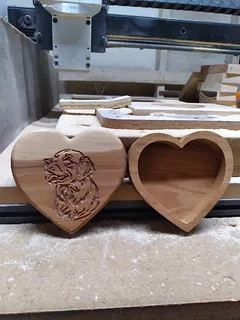

file worked great for me. I simply copy and pasted it into my project. changed depth as necessary and it cut great. my wife loves it. Hickory heart shaped box

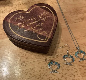

I made one of these for my wife for a ring I bought for Christmas. I sized it down to three inches to make a smaller box, and did it on purple heart as well. I found the lid fits quite tight, and it takes some effort to open it. Great project!
