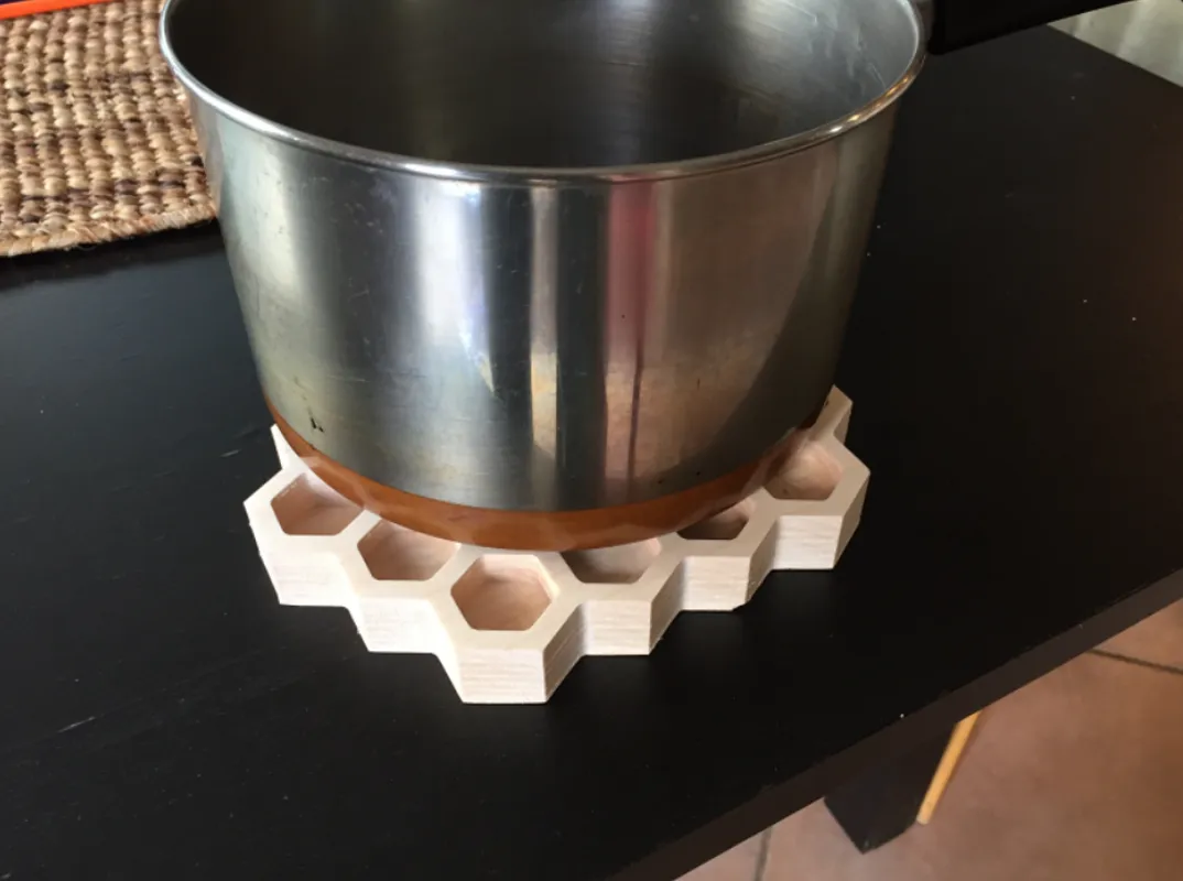

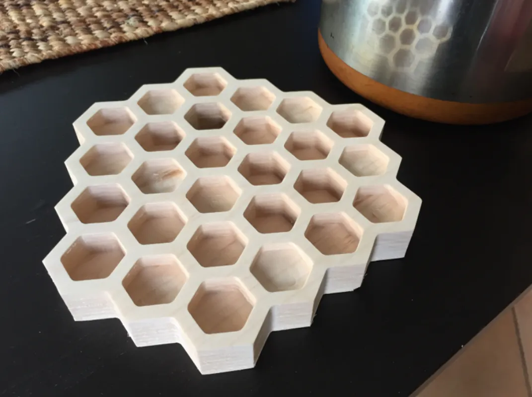

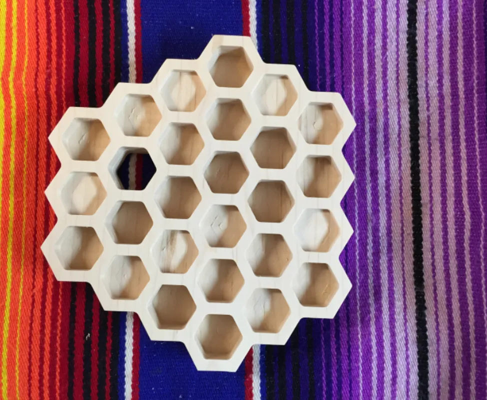

1
Easel Program

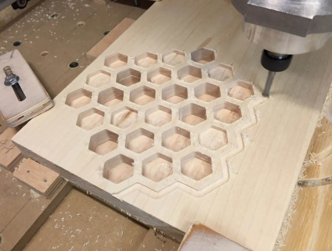

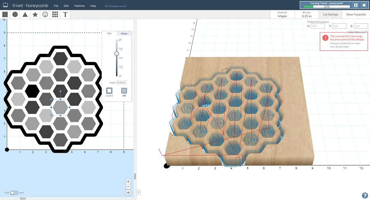

Load SVG with pattern and assign random depths to the hexagons within the honeycomb patter. Create a profile "outside" operation for the outline.
Estimated time: 5 minutes
2

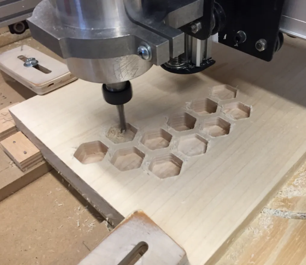

MIlling
Mill using a double flute 0.250 in bit.
Estimated time: 25 minutes
3

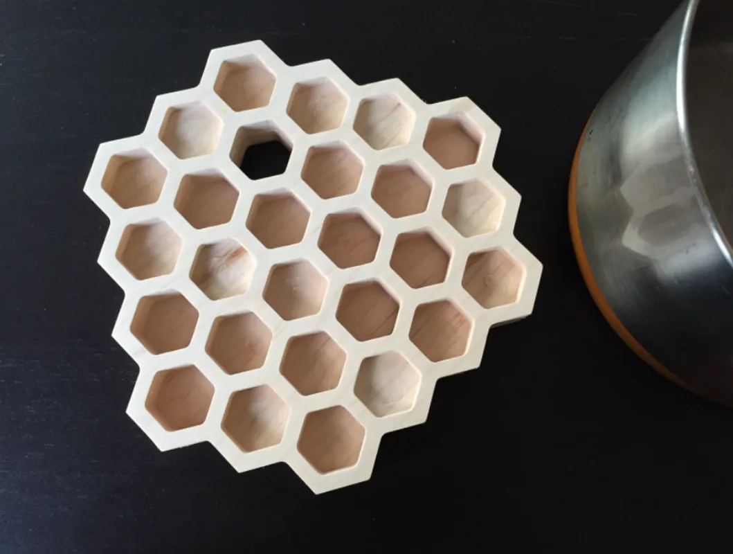

Final product
Sand and finish
Estimated time: 1 minutes

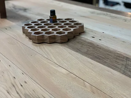

Michael SnayPro · December 15, 2019

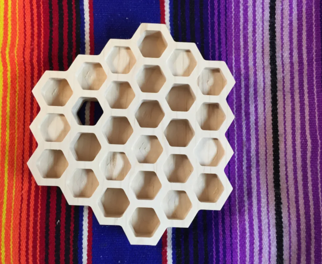

Made the complete honeycomb out of walnut and it came out perfect. What finish do you use to keep it from scorching at high heat? Made some modifications and will submit a pic.
