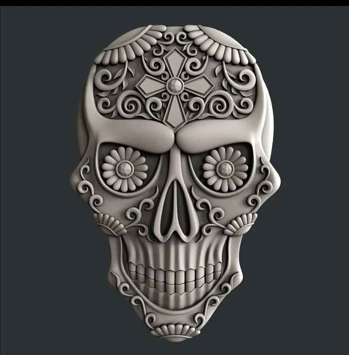

Hello...exactly which bit did you use to carve this project and where can I purchase that bit? I don't see one on the Inventables website.
heather s stearns · March 14, 2022
wondering same.
mark s · July 23, 2023
Guys that's a rendered picture, not a carving.
Roger Franz · August 22, 2023
For 2.5D Carving you need 2 bits, a roughing bit, could be your 1/4 inch downcut but for the details you need a tappered ball nose bit like: SpeTool Tapered Ball Nose End Mill 1/4" X 3" with 0.5mm Tip Diameter(0.25mm Radius) Ball Nose 5.26Deg Router Bit
