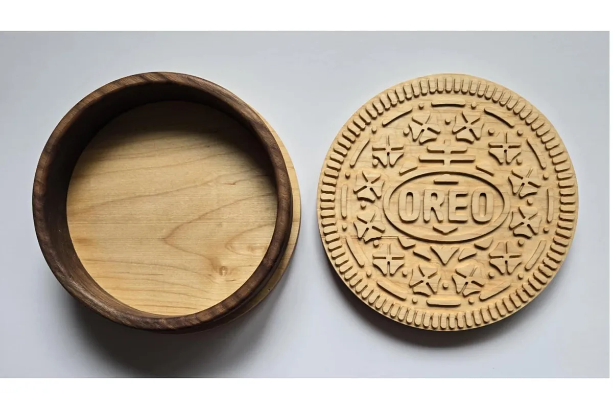

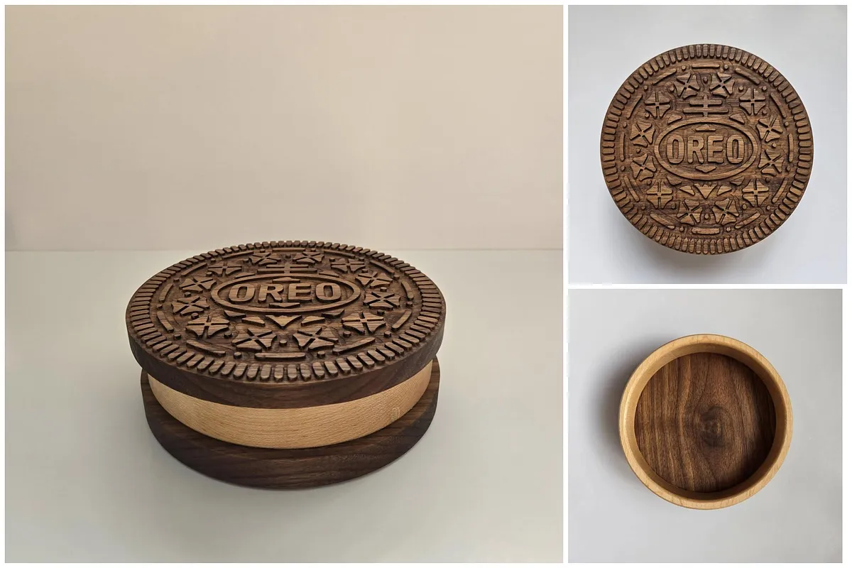

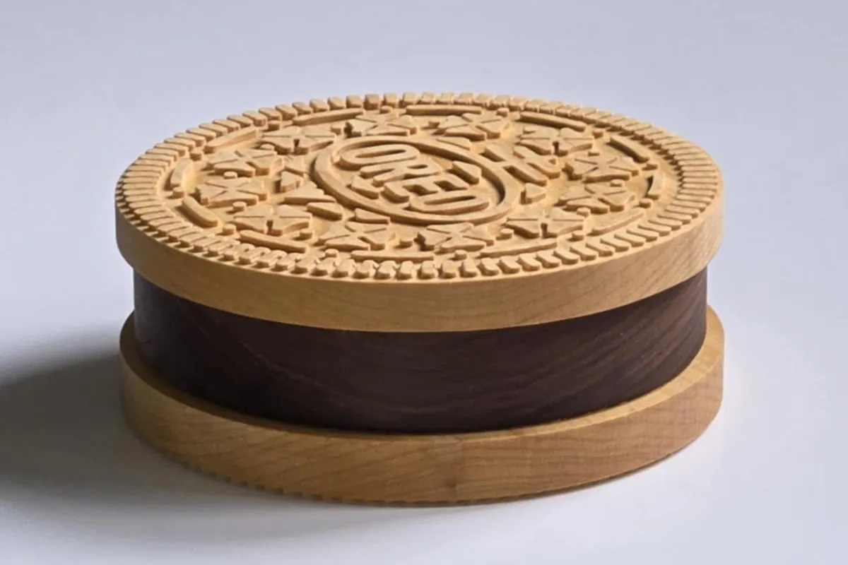

This is a keepsake box to store all those precious, personal items. It just happens to be patterned after an Oreo Cookie, Double Stuffed! The cookies are 3/4" and the centre is 1 1/4".
First, very cool thanks for sharing! both pages seem to download fine but have not tried it yet. My question is about finishing, i assume the ring is glued to the bottom cookie piece, how did you attach the top? I was thinking of insetti a 1/4 in piece and glue under the top to have a lip?
Thanks! The ring does get glued on and it was finished with Danish Oil. I flipped the top and created a small recess so the centre sits proud and sits inside the ring, maybe 1/8". Your was would work too by adding a piece on.

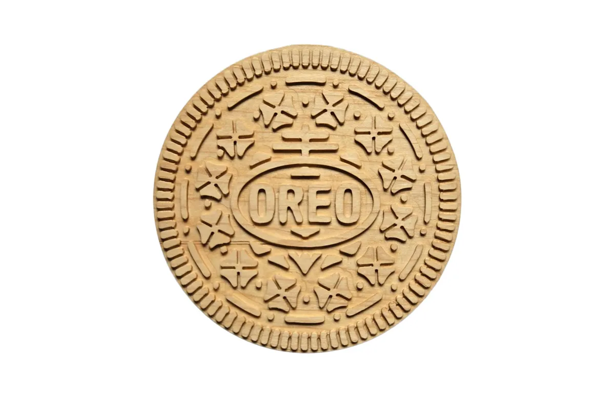

Thanks for sharing this file. It looks great, but I noticed that part of it seems to be missing — i can only see the inner circle of the projekt.
Nicole Kottke · August 11, 2025
When cutting the wood for the "filling", cut the inner circle and then cut the outer circle. You'll be left with a ring of wood. Does that help?

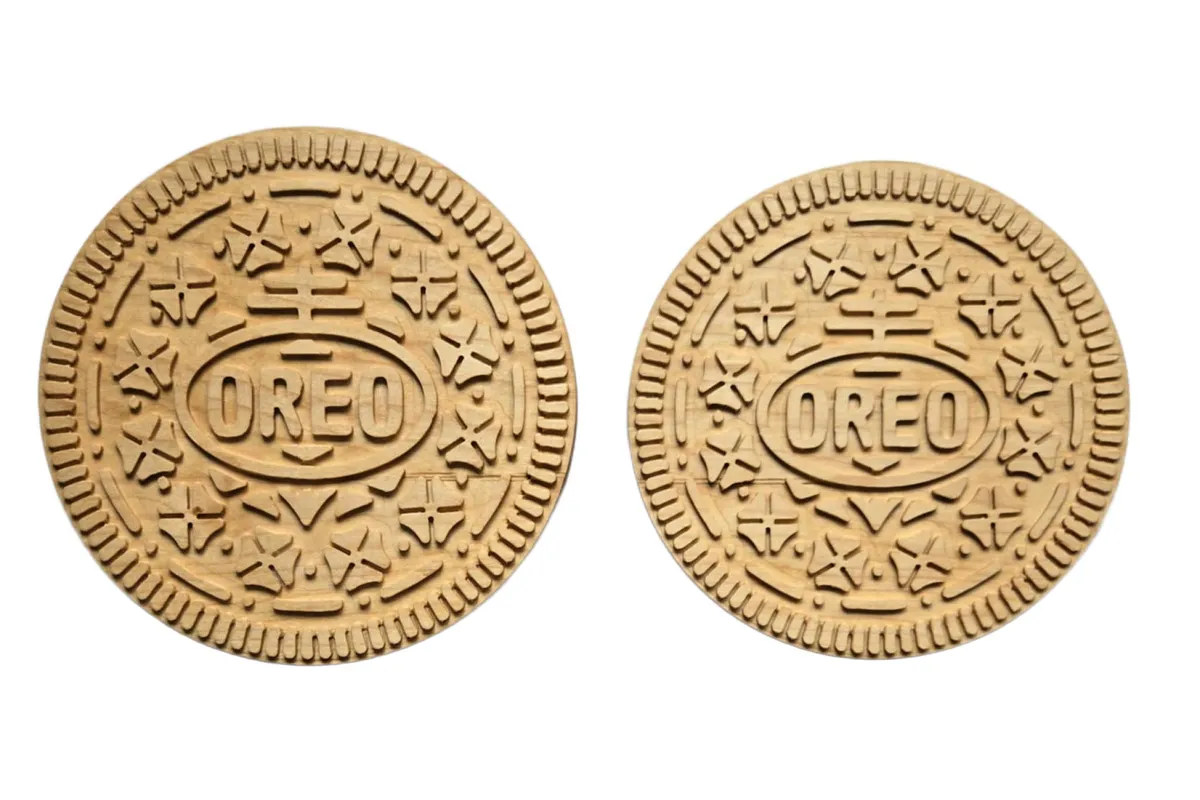

When I try to carve the top and bottom it says there is nothing to carve and stops. Nothing was changed, using the same set up. Any ideas?
william sabanosh · August 29, 2025
I found the issue. Rough is only for the circle and I was trying to rough both items.

When I download a copy of this I only get the two circles, is there another file/page that has the oreo cookie carve top ?
Dominic ZembasPro · September 06, 2025
There are two pages or parts to the project and both are there. Look at the bottom of the page and you'll see they're both there.
