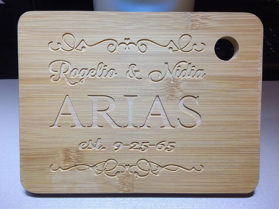

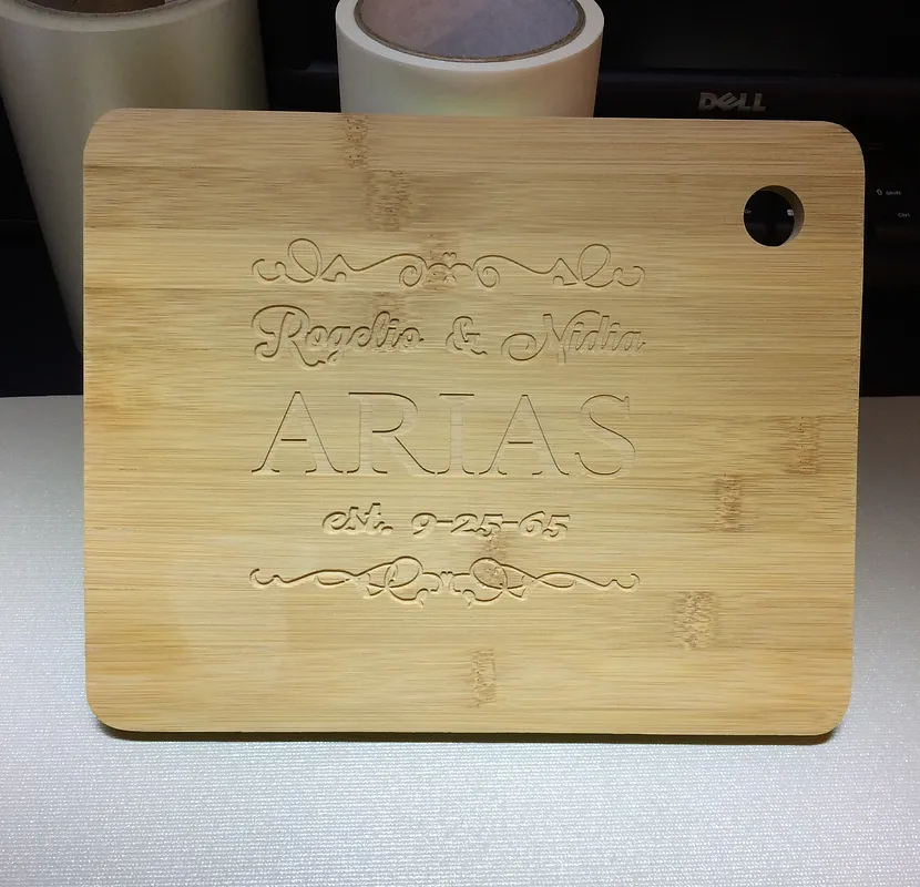

Carve
I carved the larger Last Name text with a 1/32" up-cut bit.
Keeping the same XY Zero, I then switched to a 60° V bit for the finer text and swirl lines.
60°V bit settings I used: - Bit with 0.010 in - 50 in/min feed - Plunge 9 in/min - Depth per pass 0.01 in
Alternatively you can use the default V bit settings from Easel PRO.
