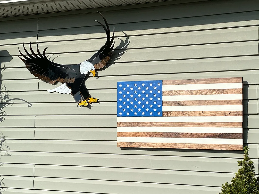

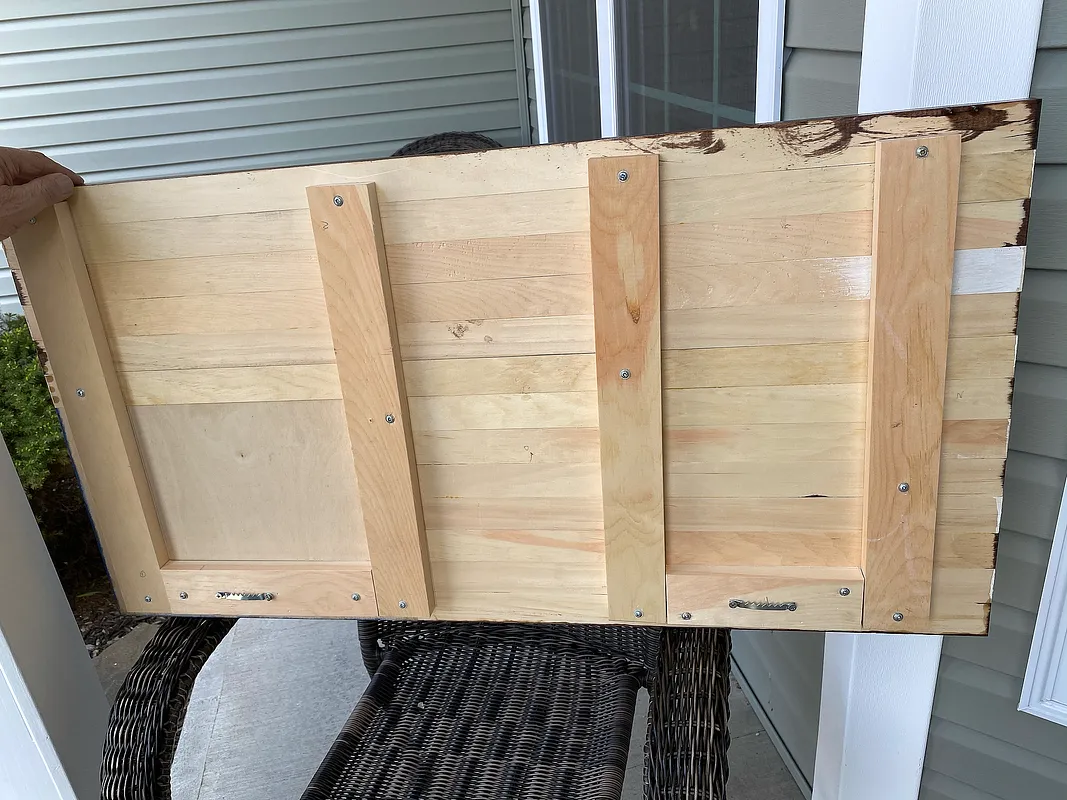

I painted the board for the stars first, Cut the stars in a little over 3 hours with a 1/16" end mill bit I painted the white stripes and stained the red stripes. After gluing everything, I reinforced the back with strips of 3/4" pine
