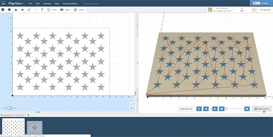

For a 19.5"x37" flag, the panel for the stars is about 15" wide and 10.5" tall. This can vary a little depending on the actual height of the top seven stripes. Just measure the height of the stripes and cut the height of the panel to match. You may need to adjust the dimensions in the EASEL project if your panel is slightly different.
I stained the panel using Minwax Tintable Water-Based Stain in True Blue from Lowes. I used a 90-degree v-bit and EASEL PRO to carve the stars. A cutting depth of .24" at .06" per pass was perfect for carving the stars.
Estimated time: 30 minutes

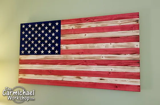

Assemble the Flag

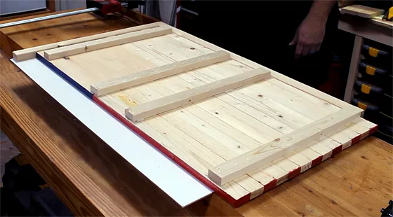

I used a blow torch to add some color to the wood and bring out the grain, then I stained the stripes using Minwax Tintable Water-Based Stain in Scarlet Red from Lowes. I used a small bead of glue to glue the flag together to avoid any squeeze out and clean up. I clamped it tight and attached 4 braces on the back for stability.

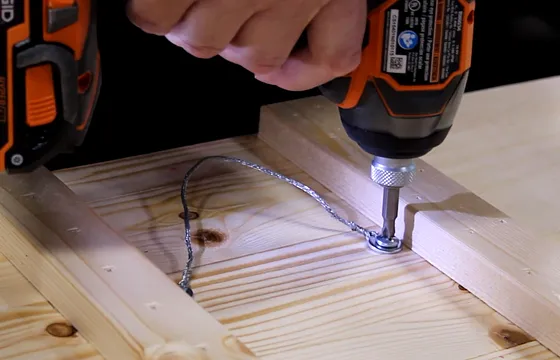

Hanging the Flag
I twisted the ends of some picture wire around washers and screwed them onto the center of the flag. This made it easy to attach a hook to the wall and hang the flag.

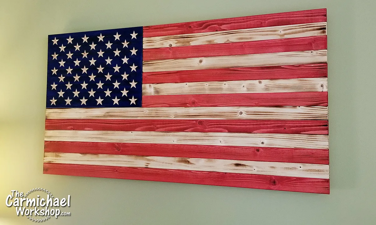

It Looks Awesome!
The flag looks awesome in my office. From what I've seen, these are really popular and are good sellers. Making and selling these flags would be a fantastic way to use an X-Carve to pay for itself, and more!
