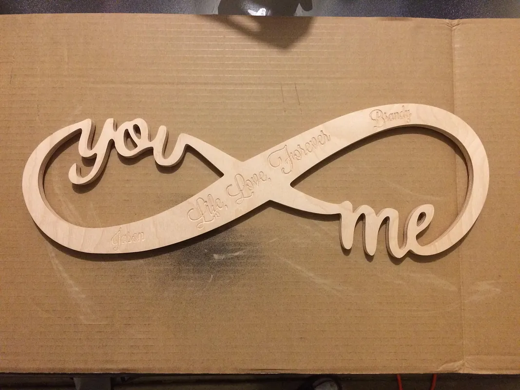

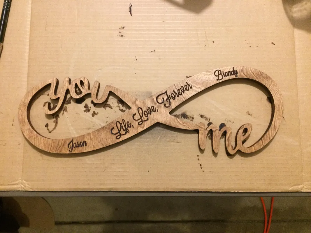

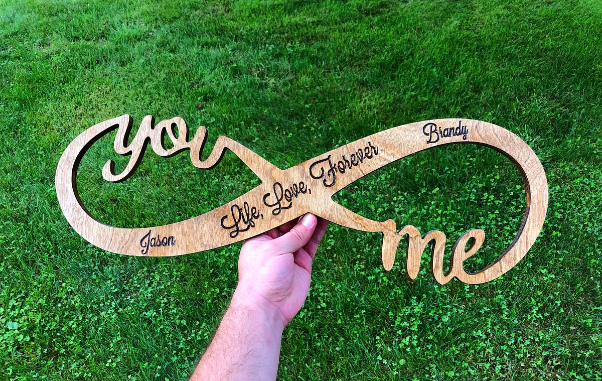

1- Use a 90 degree V-bit to engrave the text first.
2- Keeping the same zero location use a 1/8" Up-cut bit to cut the outline shape.
3- After sanding, apply stain all over.
4- Apply a heavy amount of stain in the v-carved lettering.
5- Wipe away the excess stain, but leave the sating in the lettering to give it a bold contrast.
