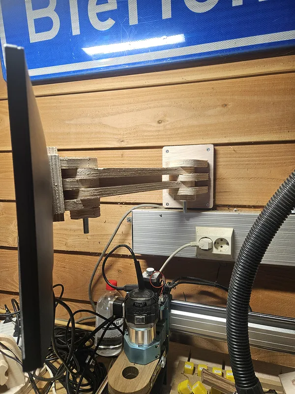

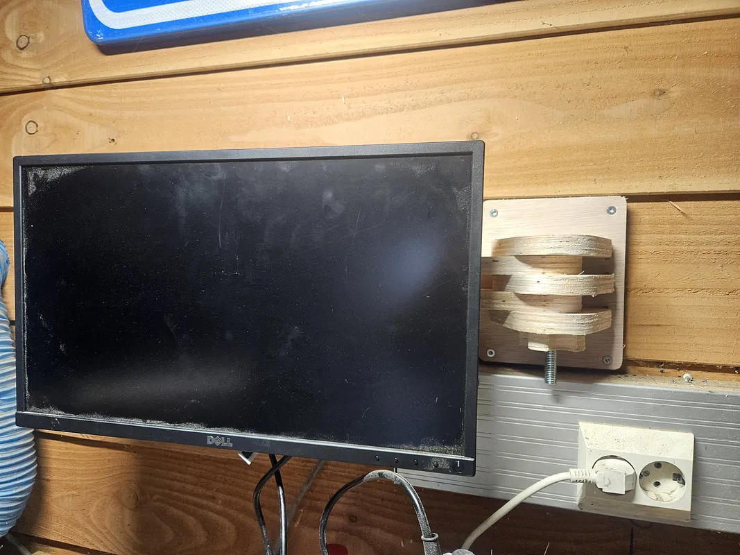

This monitor wall mount is designed to be produced on a CNC router machine with a working surface of 400 mm by 400 mm. The mount can only be moved horizontally.
- The material used is Plywood with a thickness of 18mm and the project can be processed in 1 standard sheet of plywood size 1220 mm by 610 mm (Dutch standard size in woodshop)
- The pre-drilled holes in the bottom plates can be tightened together with an M10 bolt, 40 mm long
- The arm mounts can be tightened with an M12 bolt, 150 mm long Have fun with the project
The materials used are the remaining parts of the plywood sheet used to cut the laptop stand.
