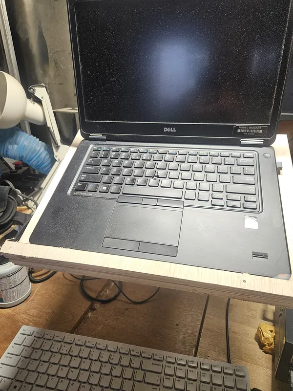

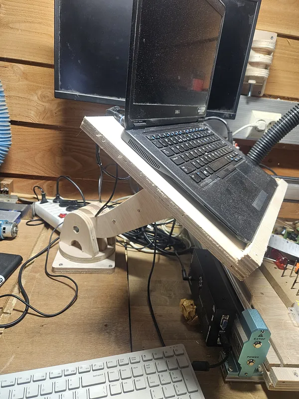

This laptop stand is designed to be produced on a CNC router machine with a working surface of 400 mm by 400 mm. The laptop stand can rotate horizontally and is adjustable in height.
- The material used is Plywood with a thickness of 18mm and the project can be processed in 1 standard sheet 1220 by 610 mm (Dutch standard size in woodshop)
- The pre-drilled holes in the bottom plates can be tightened together with an M10 bolt, 40 mm long
- The arm mounts can be tightened with an M12 bolt, 150 mm long Have fun with the project
