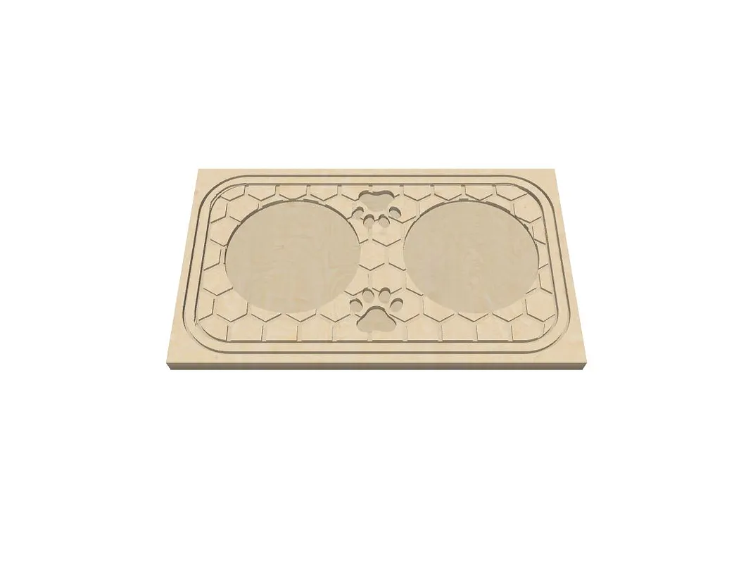

This is at least a three day carve/pour. Carve the first carve and fill it with resin, Don't move the settings on your CNC as you will be continuing after the resin dries. Second carve, plane out the inner section of the board, and the paw prints. Then fill the paw prints with resin (Different color), and let it set. then come back for the final carve, carving out the holes for the bowls and the outer edge.
Do you have any photos of the final results?
