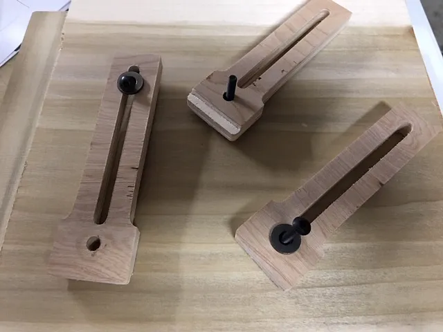

This is a hybrid of a clamp design I saw here on Easel (don't remember the author). I have adjusted them to hold the edge with a small lip. Each clamp has two places for a screw placement (I used M5). Made from 1/2" Ply and cut with a 1/4" down cut or combo bit.
x-carve 2016
