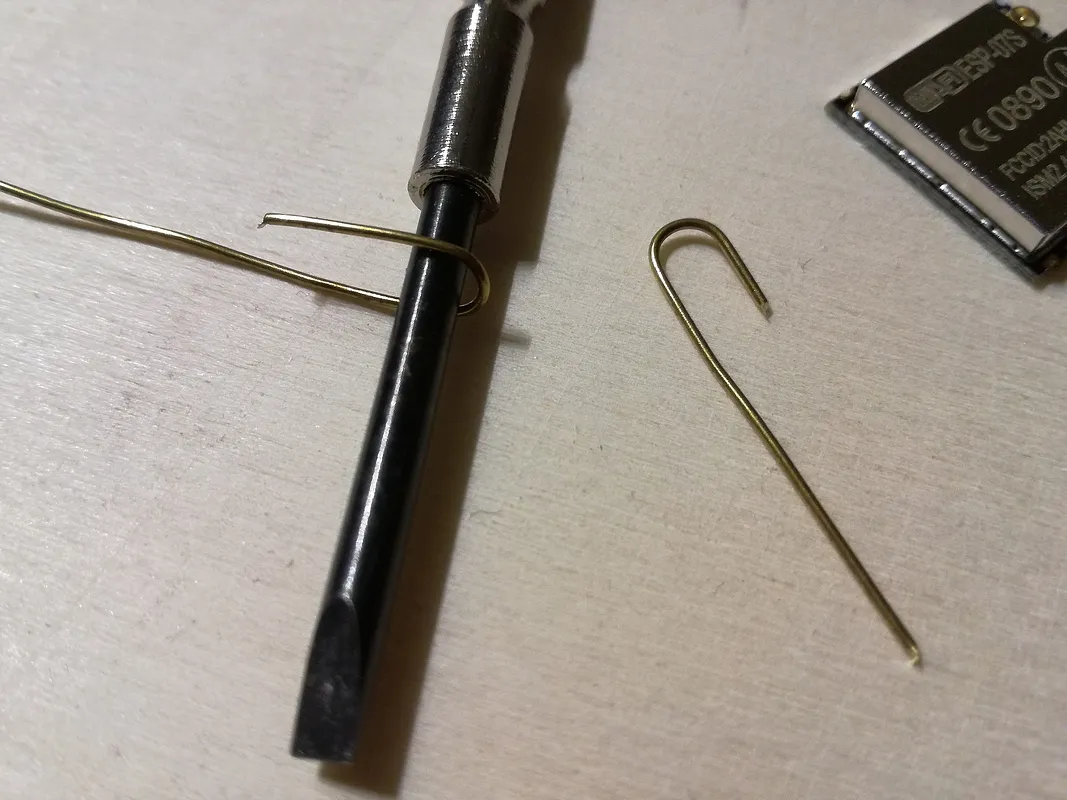

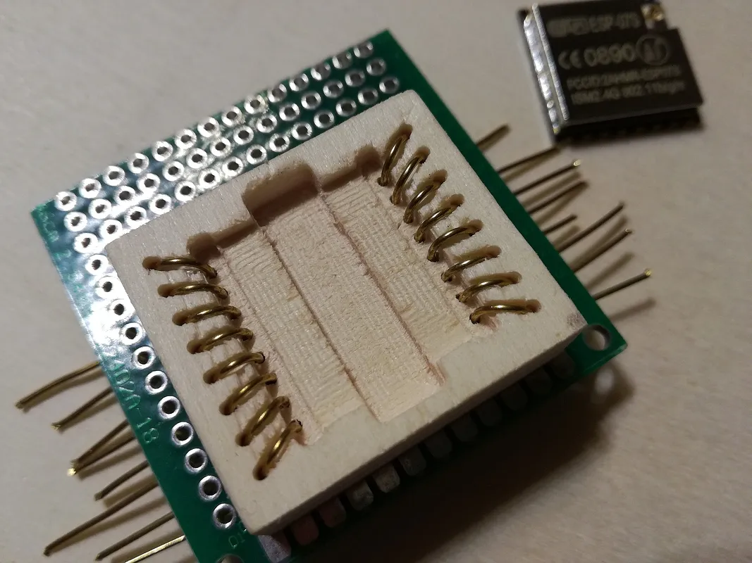

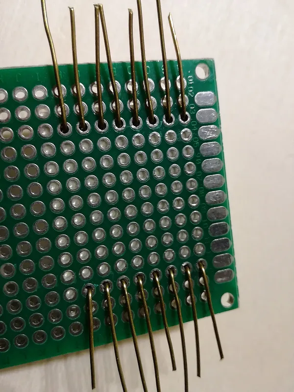

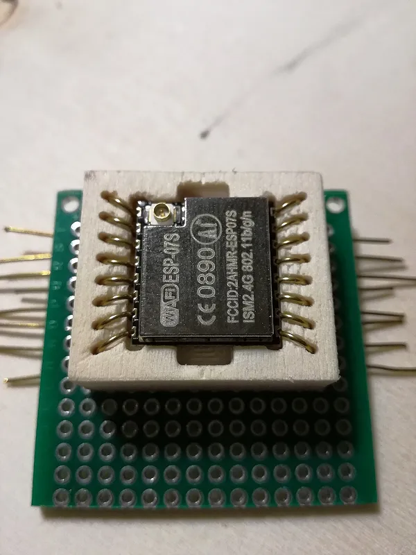

Base to use an ESP07s with a PCB. Could work also for ESP-03/04/08/12 (not ESP-12E/12F), but I not guarantee. Require 1mm bit, I suggest a 10mm hard material such as plastic or HDF/MDF (HDF is better). To curve wire I suggest a 2mm drill bit or similar, this will allow you to do the job quickly.
