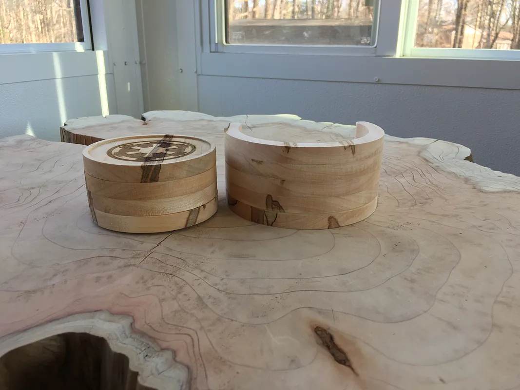

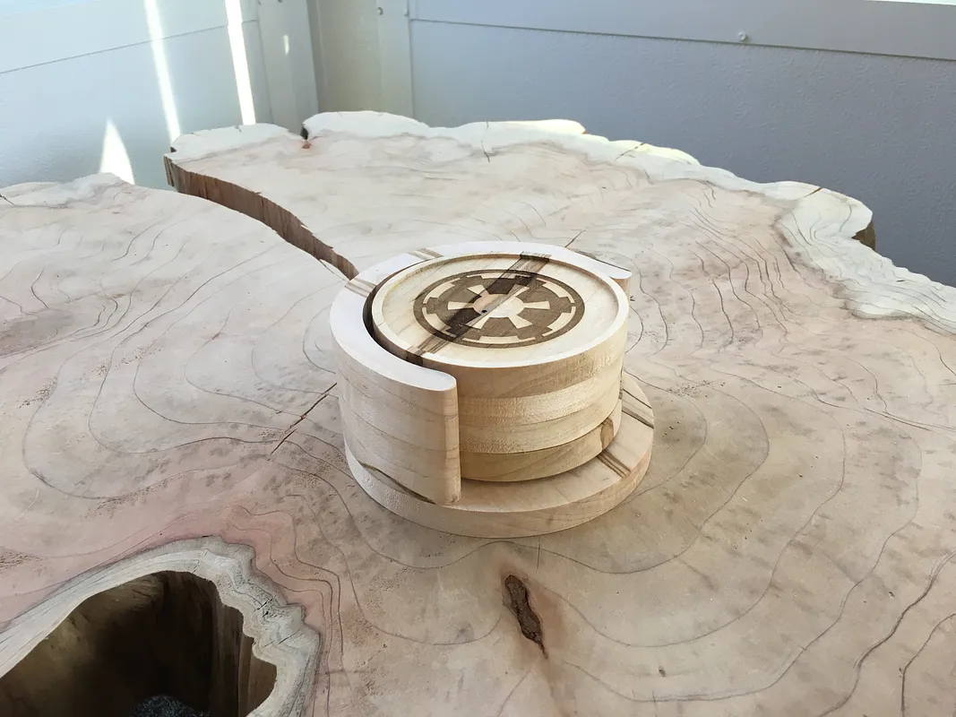

Remove all pieces and sand off the tabs. Take the holding pieces and glue all 4 of the upright parts together using clamps. Let sit for an hour.
Sand the inside of the C shape, you won't be able to sand it easily once it is attached to the bottom.
Glue the 4 riser pieces to the base using wood glue and clamps.
Sand the back so all the pieces are smooth and the ridges cannot be felt between the layers.

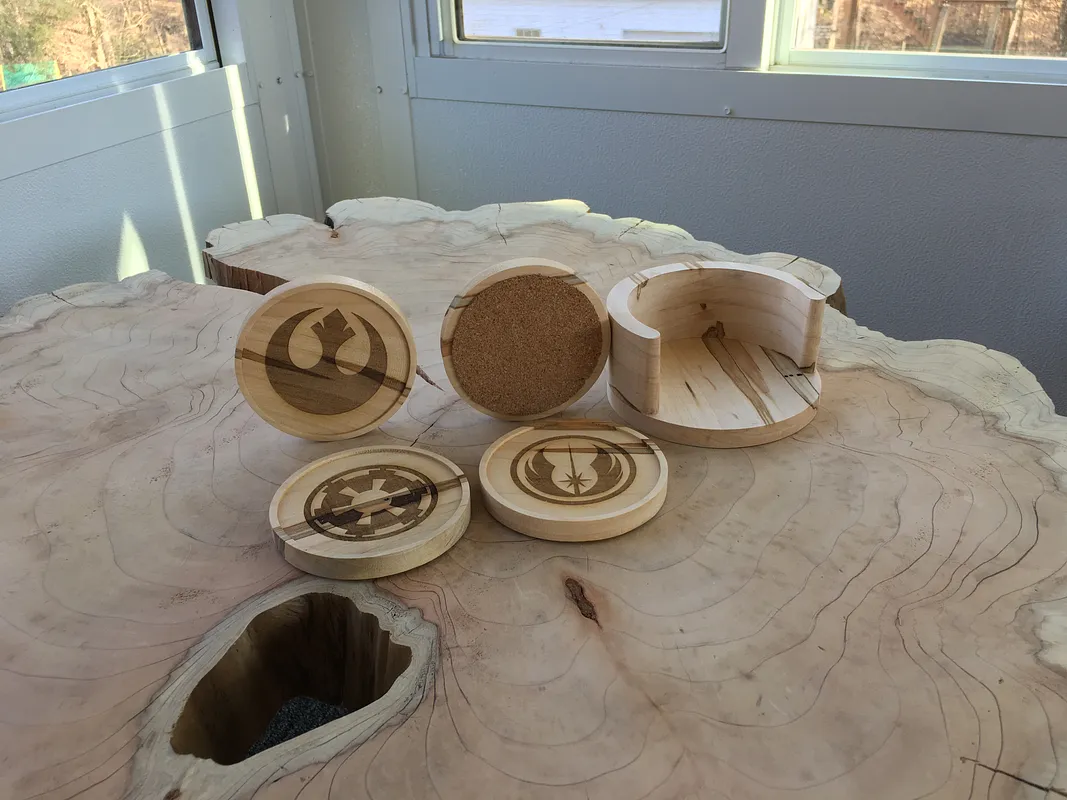

Attach Cork Bottoms
Buy some self-adhesive cork pads. Amazon sells them in 4" squares. Measure out the inside of the recessed circle and cut the cork so that it rests inside of the top of the coaster below it.
Do this 4 times and make sure the sticker is centered.
