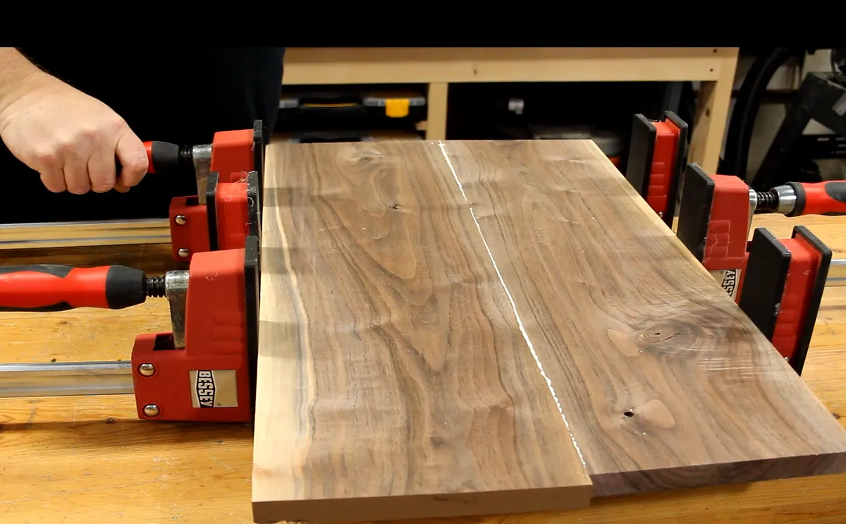

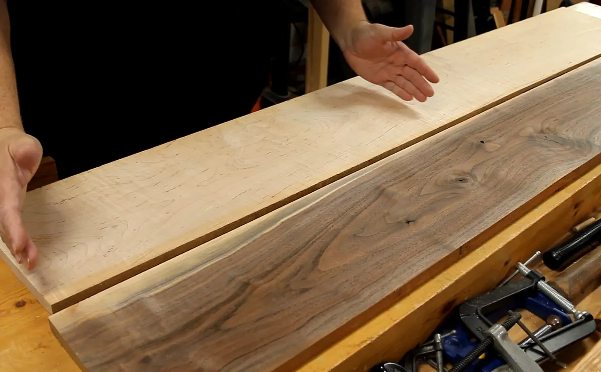

I glued up a panel of 3/4" thick walnut that was 16"x24" for the table top. I cut a section of 9/16" maple that was 9"x20" for the legs. Note: I used my planer to plane the maple board down from 3/4" to 9/16" thick so that the guitar tuners would fit. I adjusted the mortises on the underside of the top to fit this 9/16" width as well.

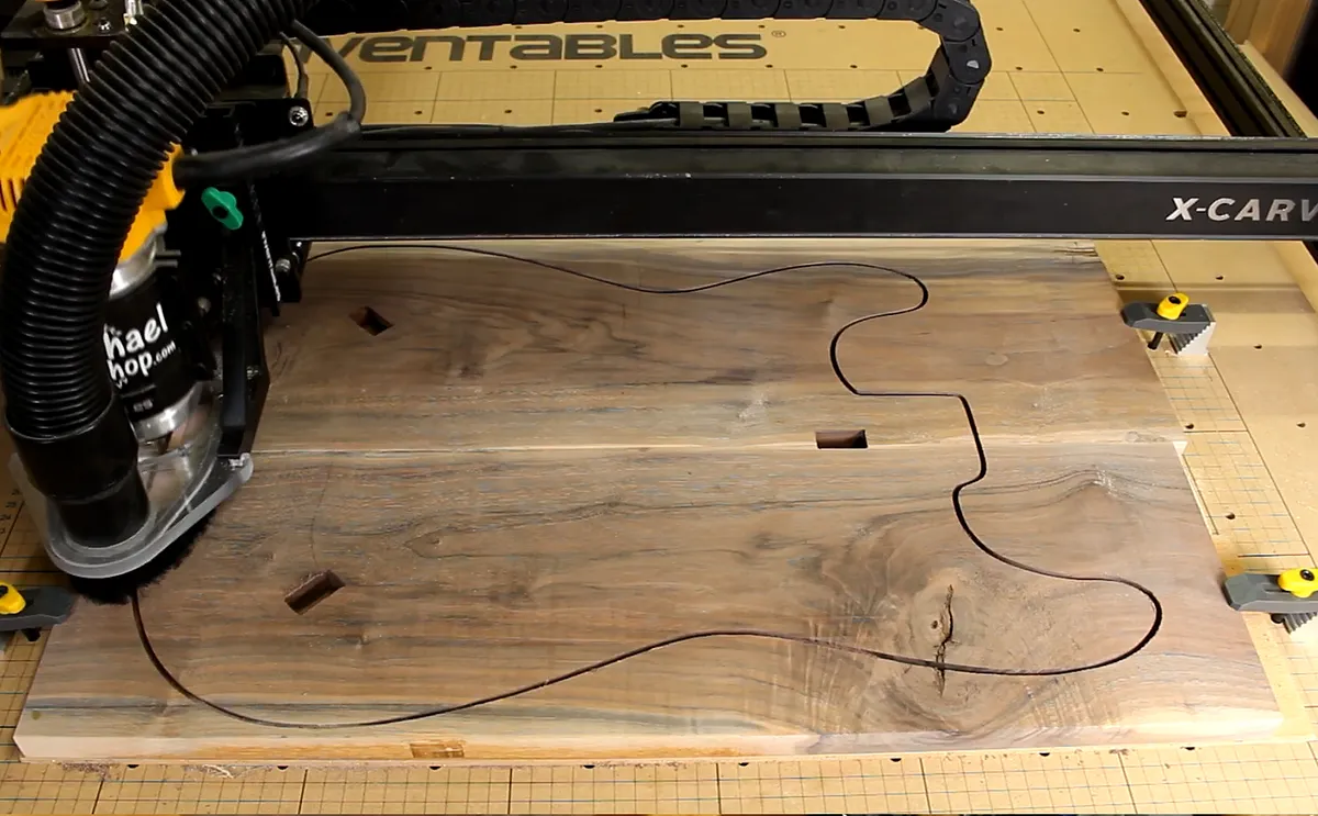

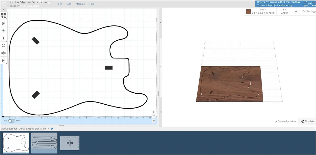

The first job is to cut the table top. Mount the blank on the X-Carve with the bottom side up for cutting the mortises.

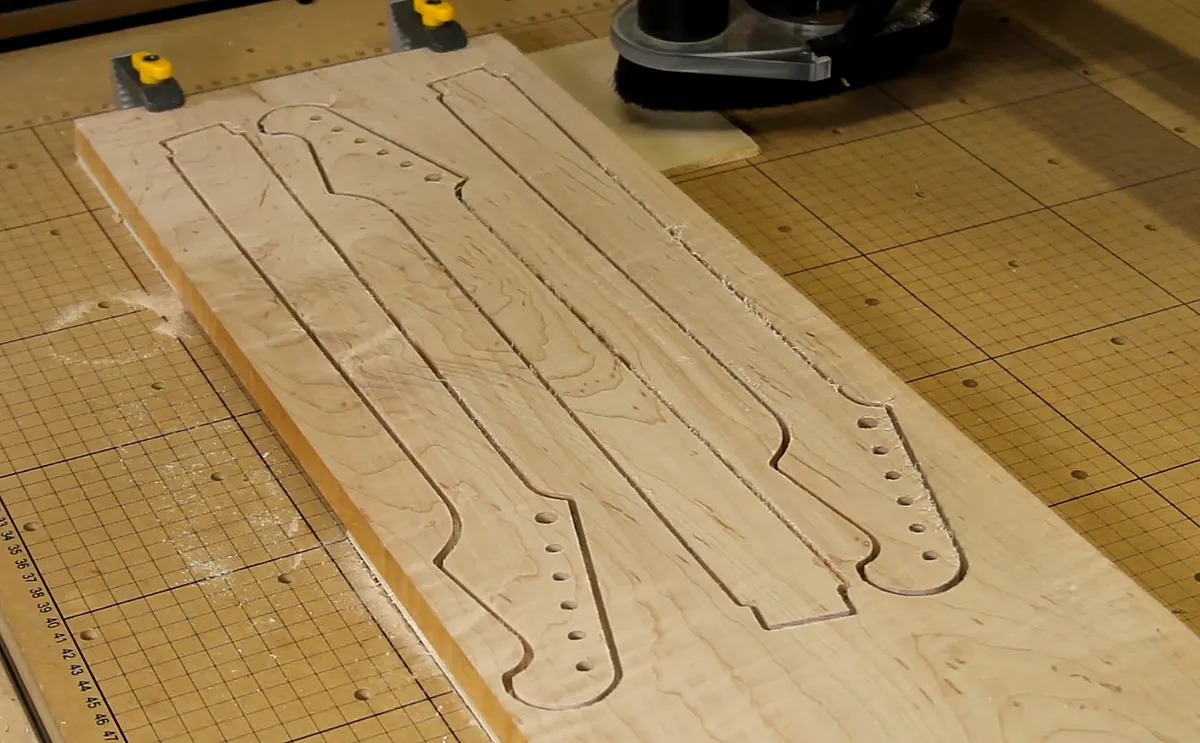

The second job is to cut the legs (necks).
Estimated time: 90 minutes

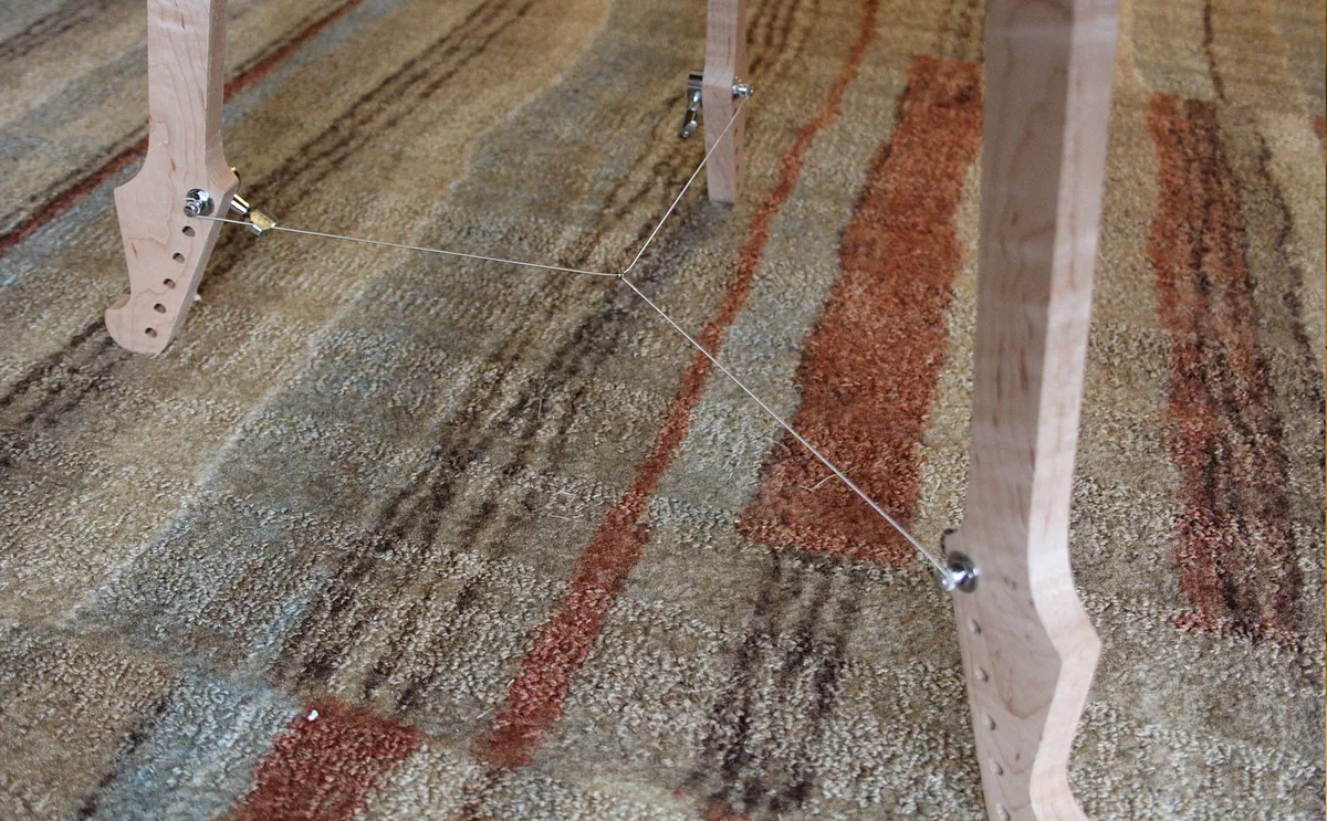

Measure a section of guitar string to form a V shape between the back two legs and cut it to length. Thread the cut string through the ring on the other piece of guitar string. Wind the string onto the tuners to form a Y between the legs.

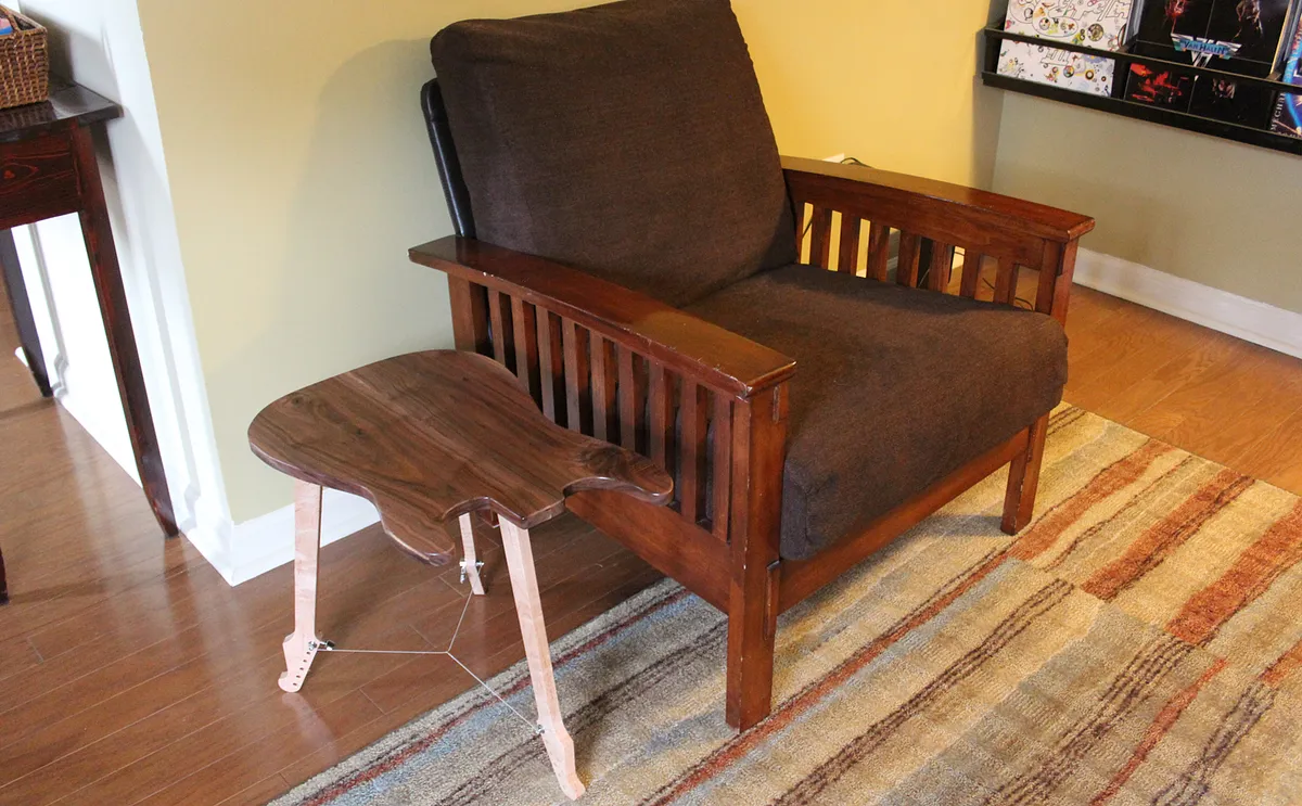

FINISHED!

The Easel project has two jobs in it. Tab 1 is the table top and tab 2 contains the legs. Thanks!
Steve CarmichaelPro · January 21, 2020
unfortunately, no Tab 2 ?!!
francois giroux · January 25, 2020
I added a picture to step 3 of the instructions. It shows the Easel project. Look at the bottom of the picture to see tab 1 with the guitar shape and tab 2 with the legs.
Steve CarmichaelPro · January 25, 2020
where is tab 2
Florian Zigan · January 25, 2020
Click the blue "Open in Easel" button on this project page. When the project opens, there are two tabs at the bottom. See the picture in step 3. Email me at thecarmichaelworkshop@gmail.com if you still can't find it.
