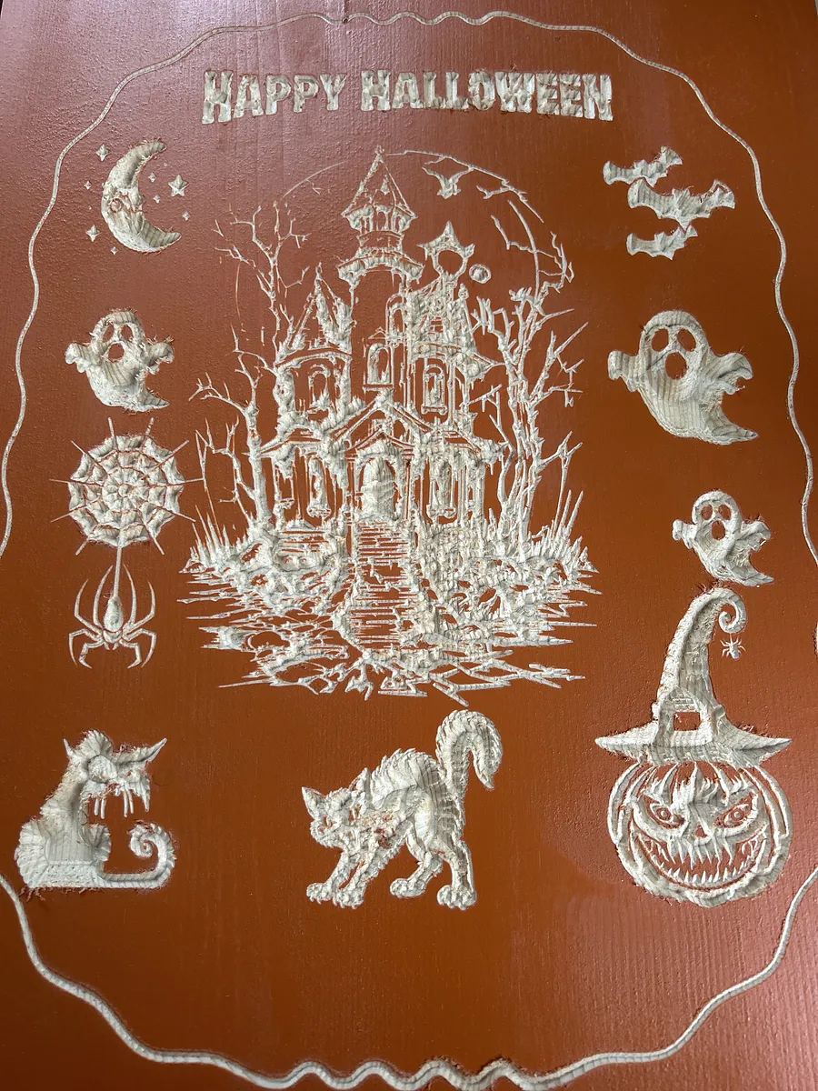

Did you want this area of the design to have more detail and thinner lines when you carved it? Two ways to get that would be using the new V-Carve Inlay tool or converting it from a fill to an on path outline.

5 hr 8 min total · Sainsmart Genmitsu 4040 Pro Reno · 3/4" Pine
