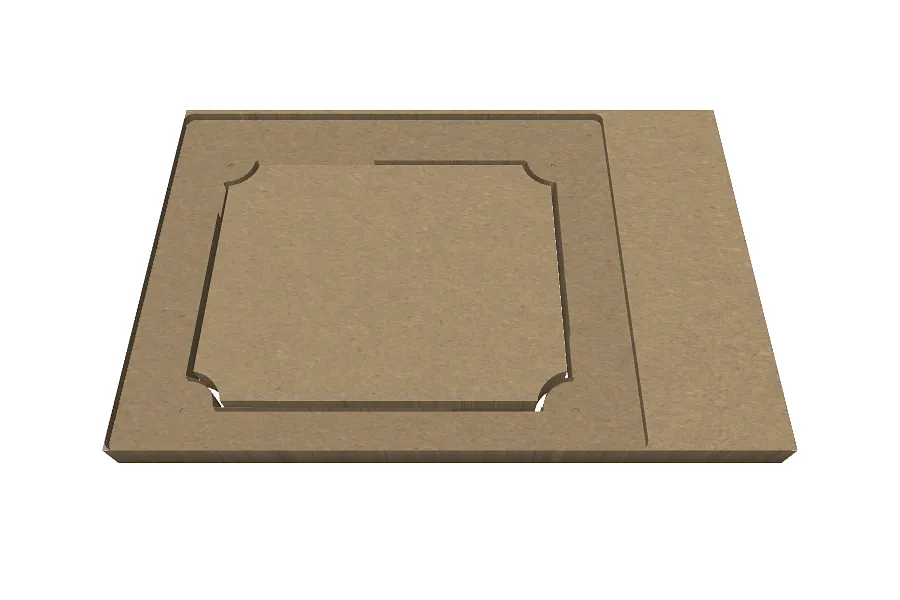

The inlay to be cut to install a chinese router base of 24x20cm. The material choosen is MDF, but I strongly suggest plywood or even better laminated wood. You might want to remove drill holes. Please, check notes and verify mounting holes distances for your model.
Notes
Please, verify mounting holes distances for your model: - 3cm from side borders; - front holes are 2cm from border; - back holes are 3.5cm from border.
