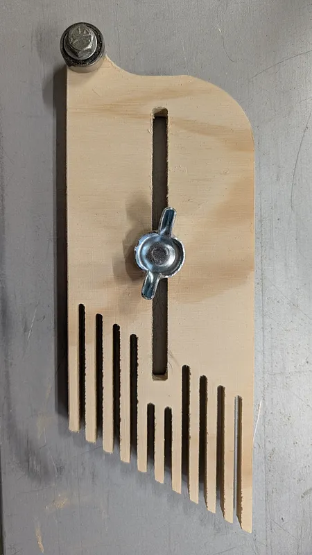

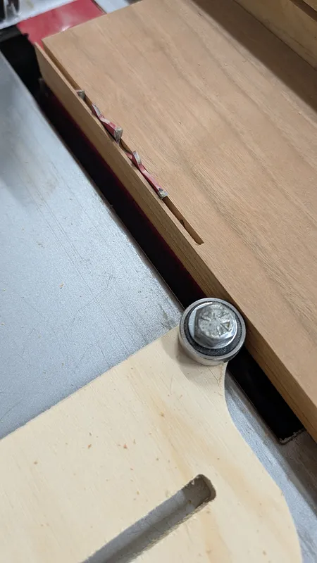

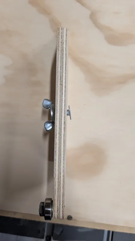

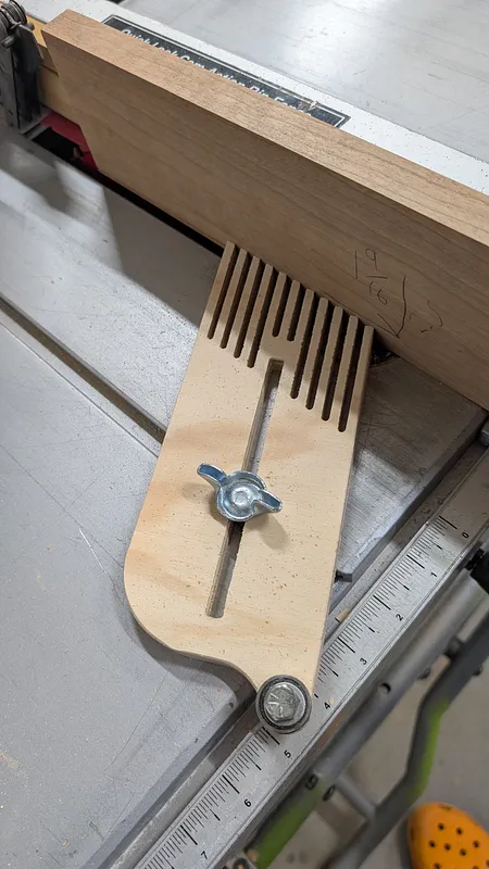

1/2 inch plywood. You'll need to digitally adjust screw slot and lengths possibly to fit your needs. You'll need a skateboard type bearing and a bolt with washers and just thread the bolt into the hole. Also needed is a wing nut type thing and bolt to clamp it down into the table saw track.
