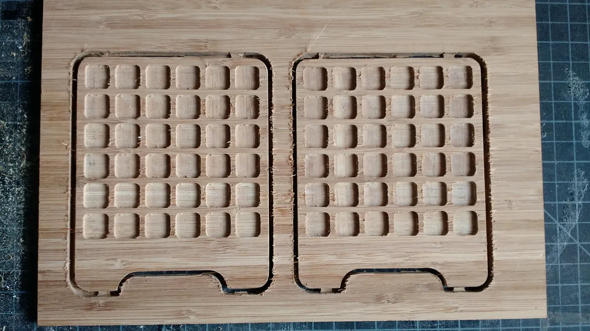

Mill Boxes
Mill the main boxes from 3/4" material
Use this EASEL "link":http://easel.inventables.com/projects/wDsGw8JoZL8O7Hl6f8c1eQ
Battleship Game — Mill Boxes

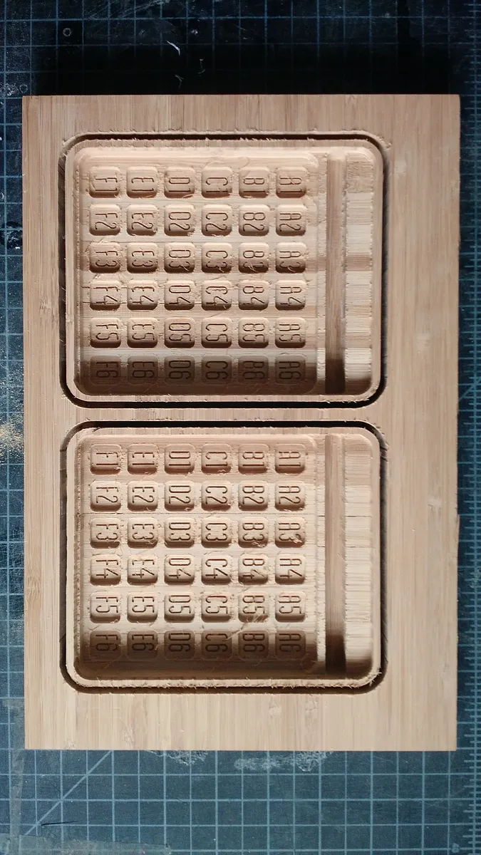

Etch Boxes
Change to a 1/32" bit to engrave the letters and numbers into the grid for the box
Use this EASEL "link":http://easel.inventables.com/projects/hPW_tznDAEG0tEp8W3N75g

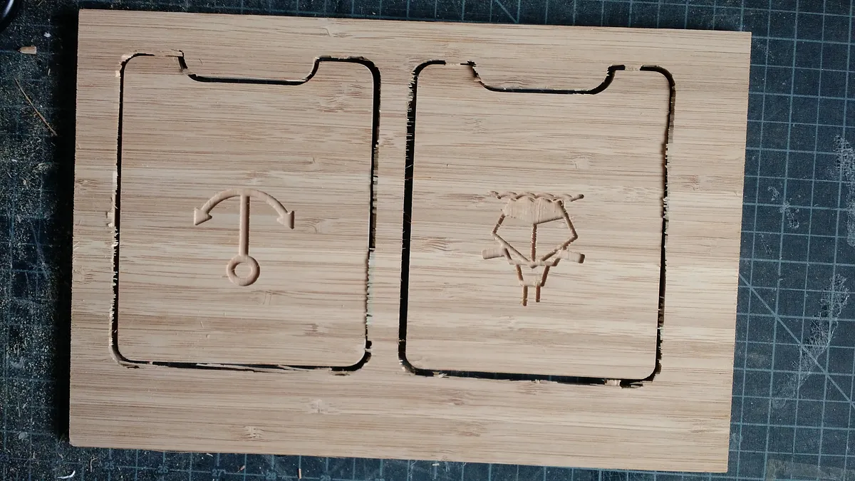

5
Etch Logos into Lids
Flip the lids and align to mill the logos
Use this EASEL "link":http://easel.inventables.com/projects/S5XGyXKt9bGZ-_EANUk6Zw
Battleship Game — Etch Logos into Lids

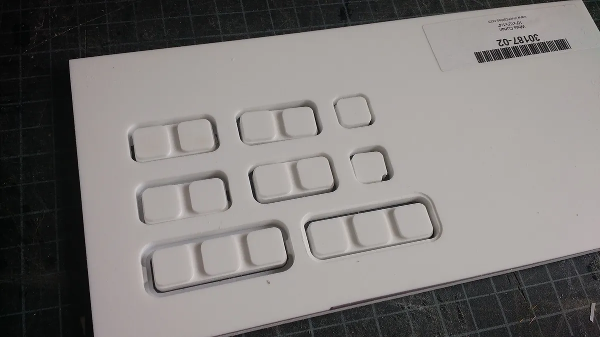

6
Mill the ships
mill the ships out of 1/4" material
Use this EASEL "link":http://easel.inventables.com/projects/qMUsISi8XM-c5b1zkeLpdw
Battleship Game — Mill the ships

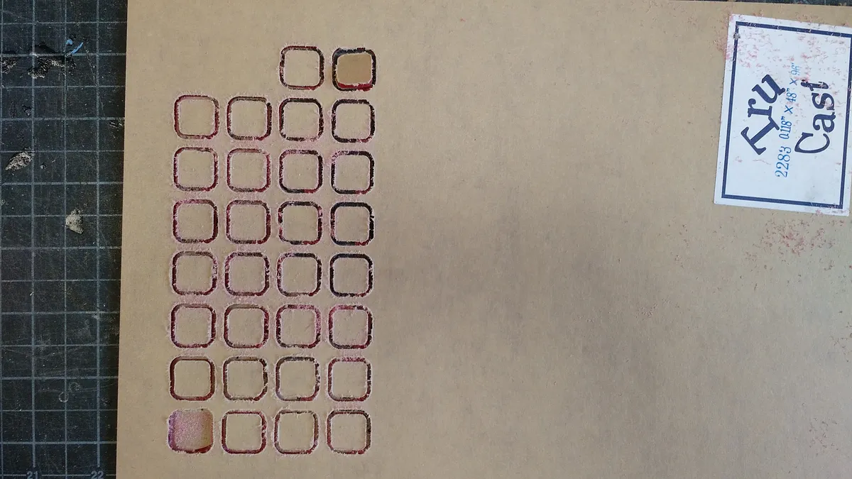

7
Mill the black tiles
Mill the tiles from 1/8" material. We used matte black acrylic. This is a good cut to use double sided tape.
Use this EASEL "link":http://easel.inventables.com/projects/LyxxfGRidOTX8CmQOzR2dA
8
Mill the red tiles
Mill the tiles from 1/8" material. We used translucent red acrylic. This is a good cut to use double sided tape.
Battleship Game — Mill the red tiles
