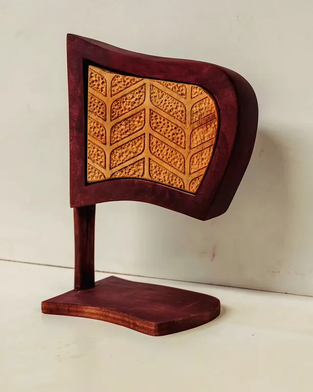

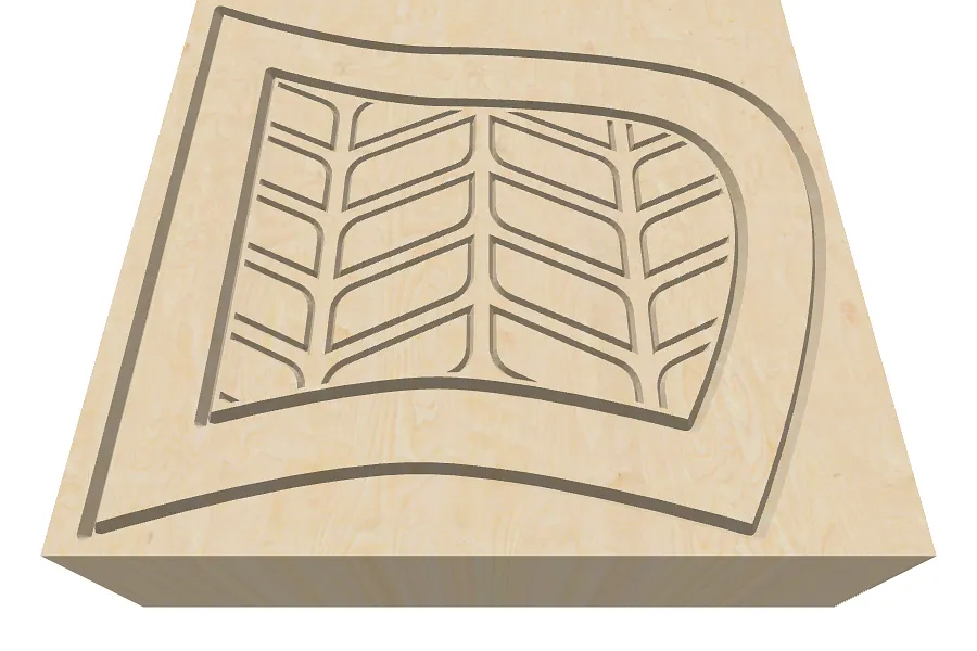

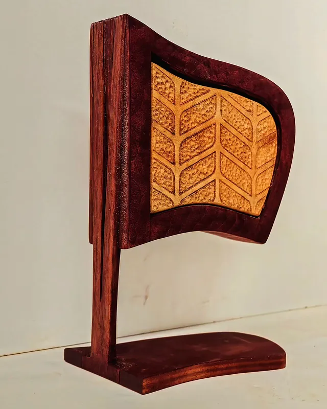

check dimensions before carving! carve the center. then carve the exterior and box at .10-20 with a 60 degree v bit. this allows your bandsaw blade to fall into the groove and guide along the cut. after pulling from the machine i used a dremel with a ball mill to texture between the "leaves".
