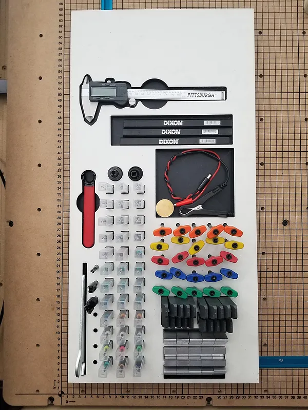

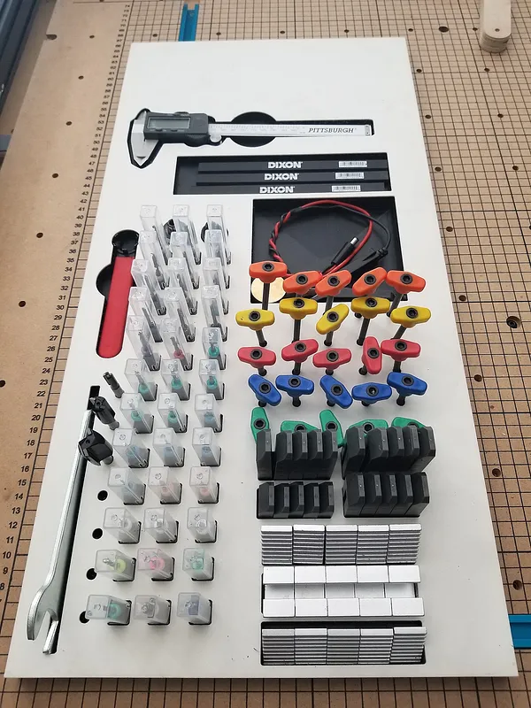

This is my version of the storage from the one from Chip Clark published he made 3 different ones and I just combined them and used a single sheet of 3/4 HDPE. I used a 1/8" Solid Carbide 2 Flute Straight End Mill to do all the carving and it took about 12 hours to complete.
I adjusted the size of the holes on the t handles after i completed my project I did not like how big they were on my version, I may remake it later on.
