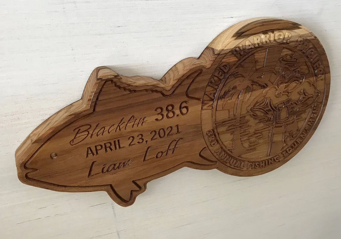

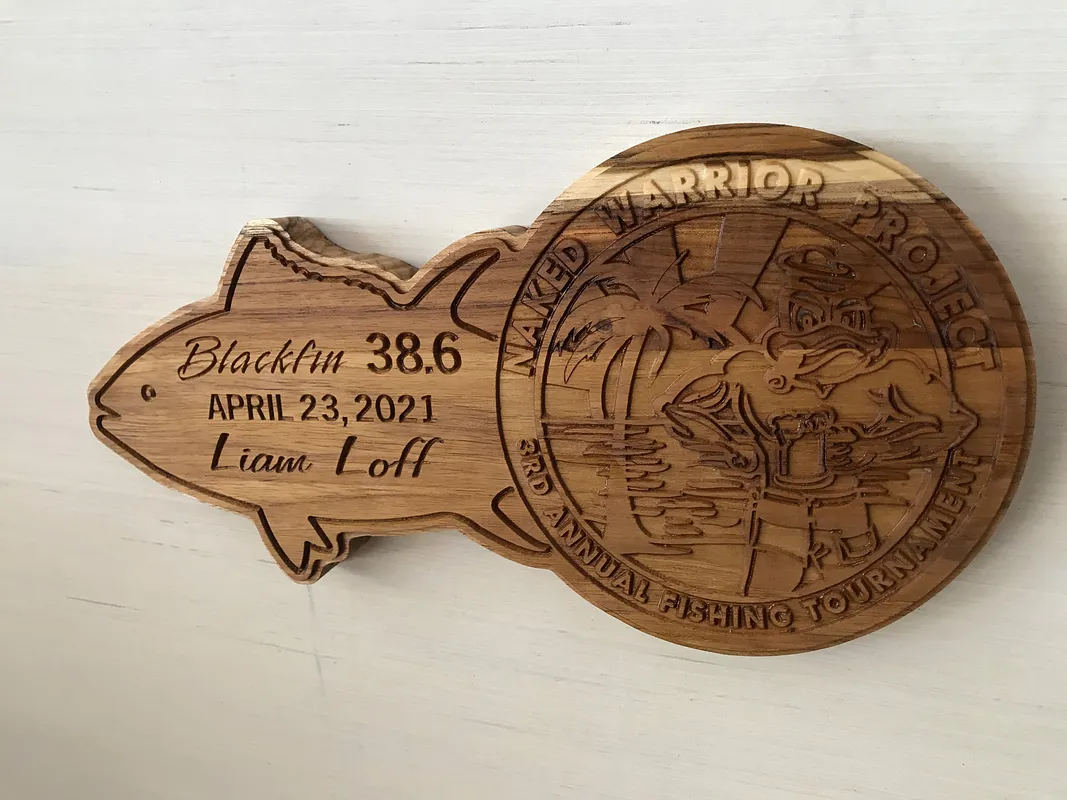

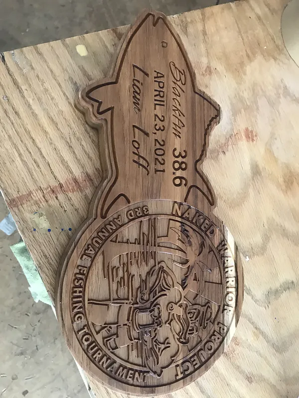

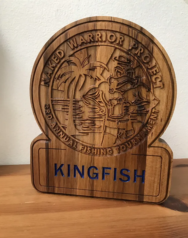

Fishing tournament Trophy and Plaque Made In 1" Teak Wood used tuna from easel art files incorporated into my design used 1/8 bit to rough carve 60 degree vbit to carve details and a 1/4 compression bit for the step edge and carve out
