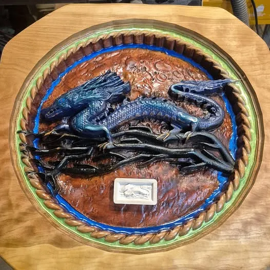

Thanks. This was a relatively simple design :-) Never gonna carve it again so figured id share. I like seeing my designs in the wild. This is the dragon design i just made and carved and painted :-)
