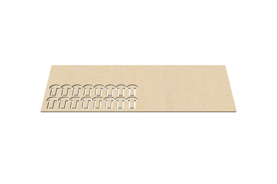

Measure your shapes and adjust to fit! These work great for holding down warped 1/32'' veneers for engraving/cutting!

7 min total · X-Carve · 0.17" Birch Plywood

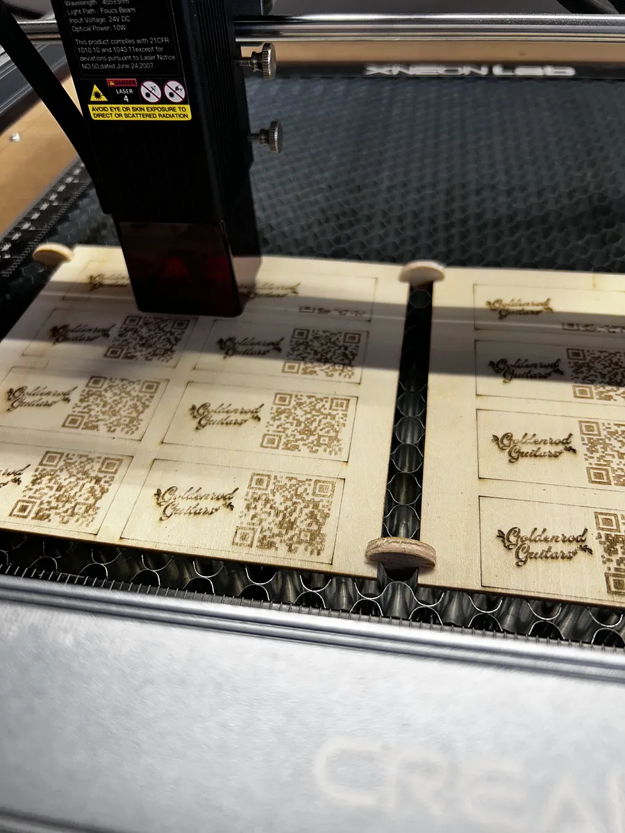

Do you have a photo of these in use? I'm curious how they work.
John McWhirterPro · October 16, 2026
Yep, they don't need to be super grippy!
Bo HicksPro · October 16, 2026
I just uploaded one. They push down inside the honeycomb and pin the workpiece in place. I ordered some really thin veneer and it was warped so I had to come up with something to hold the pieces flat for engraving/cutting.
Oh they are for a laser! That's the honeycomb part that I wasn't understanding. I'm guessing they are just press-fit.
added a photo
Are they held down on the other side or just hanging through the grate?
Zach KaplanPro · October 16, 2026
They are cut to wedge into the honeycomb. So you would adjust the width to the size to your honeycomb bed.
