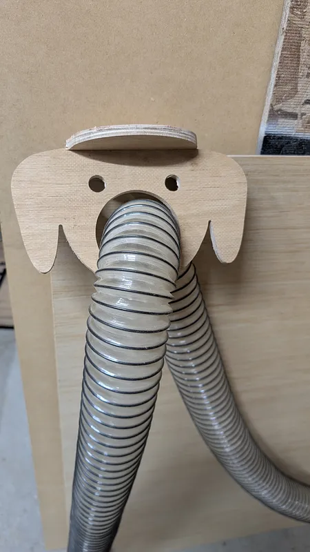

Dust collection hose mounting brackets for 2.5 inch hose. Elephant face is glued and screwed into the top plate and the plate is mounted to the ceiling. This is set up for 3/8" plywood but to adjust for different thickness, adjust the rectangle width on the mounting plate
Notes
One small cabinet screw and some wood glue to assemble.
