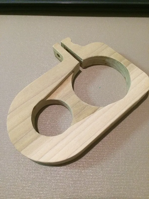

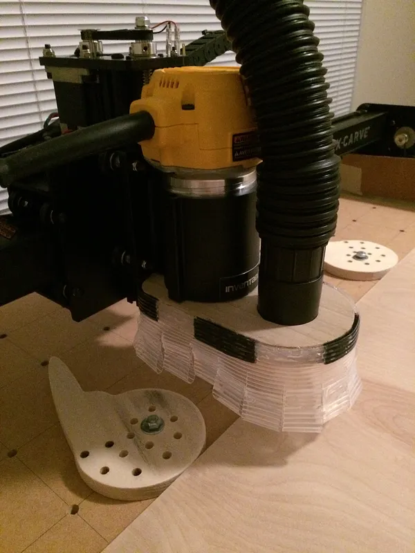

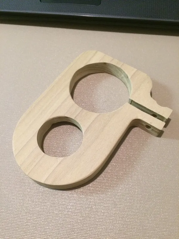

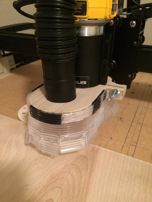

Materials
1) Poplar Board - 0.75" x 5.5" x 24" - $5.74- Home Depot
2) 1/4"-20: 1.5" long bolt, washer, and wing nut
3) Premium Shelf Liner - Home Depot or Lowe's https://www.lowes.com/pd/ClosetMaid-15-75-in-x-8-ft-White-Shelf-Liner/3373768
4) Adhesive backed velcro https://www.lowes.com/pd/VELCRO-2-in-x-48-in-Black-Roll-Fastener/1052627
5) Hot glue gun

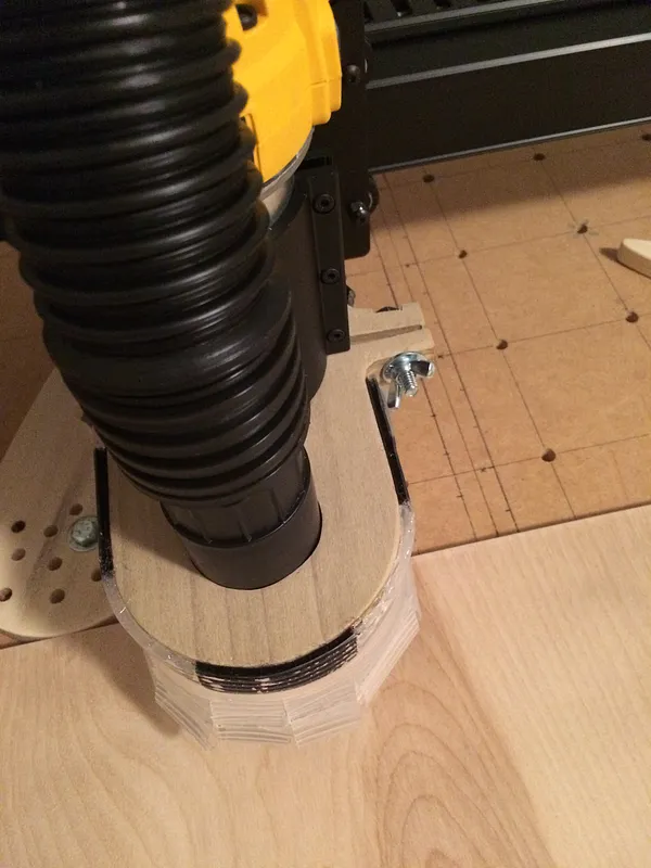

I would like to make this, but doesn't it interfere with the locking mechanism for the collet on the dewalt 611?
Paul Housinger · March 05, 2018
It does, I take it off every time I have to change bits. I used a Wing nut so that I can loosen it quickly without tools. One other thing, use some strong wood, after some months of use the tabs for the bolts broke.
