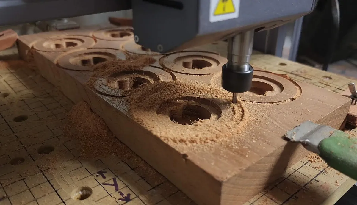

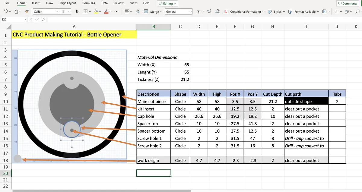

If you like CNC Product Making, or you are a beginner into the interesting CNC world, you will like this video. It shows my workflow to create a wood Bottle opener with an insert kit, and using Easel.
See tutorial here: youtu.be/HSNqEtbMzPA
