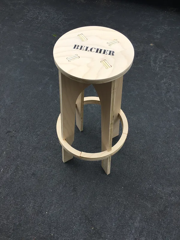

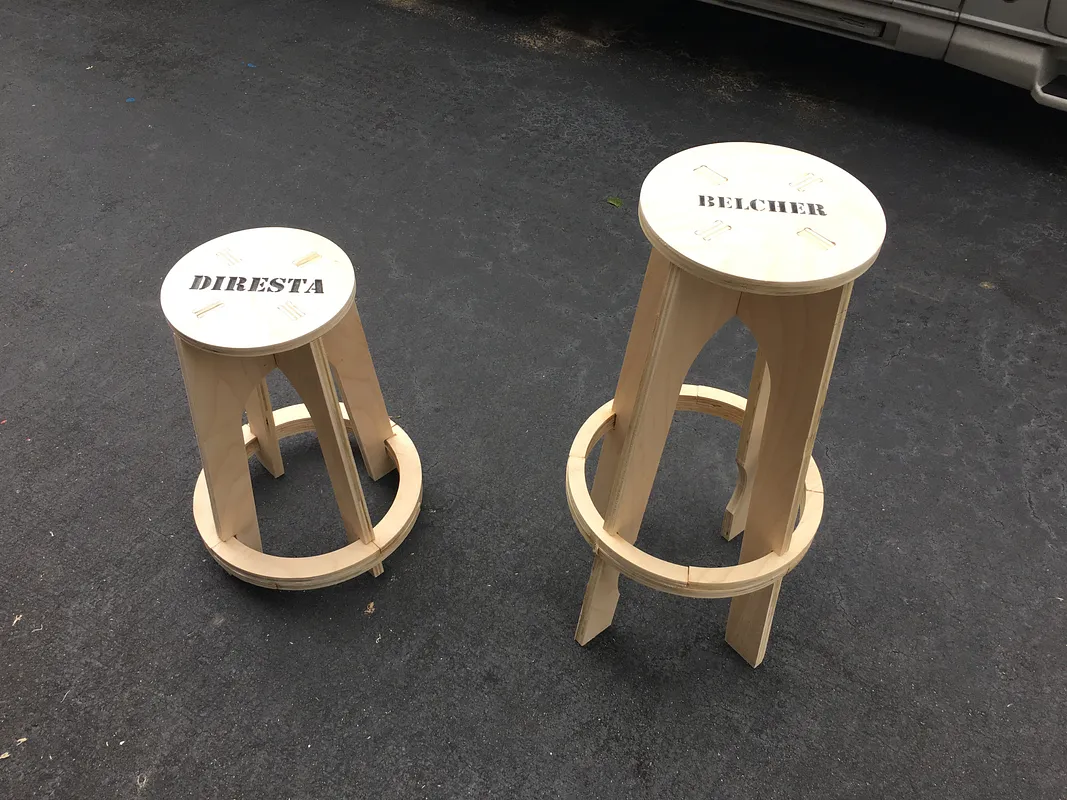

This is designed for 3/4 inch stock, and includes a gcode file for the DIRESTA logo using a v-carve, therefore you will not need to fix the A. (It also looks a lot better).

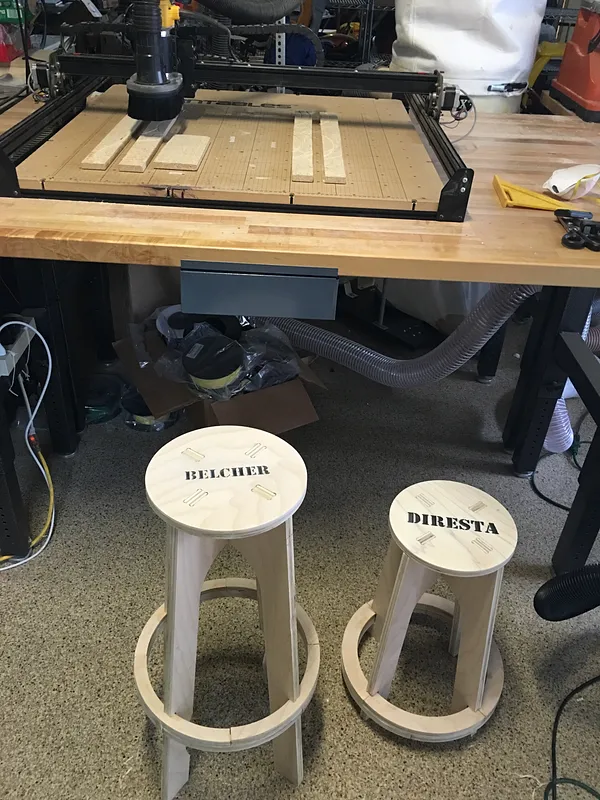

Be careful with this, as a large portion of the sheet is used. I increased the tab height to .2 inches, given so much of the sheet could come loose. I start with an oversized 32 x 32 inch sheet and use double sided tape. I then move my X and Y as close to the bottom left as I can. This entire design will fit into a 30x30 however.
