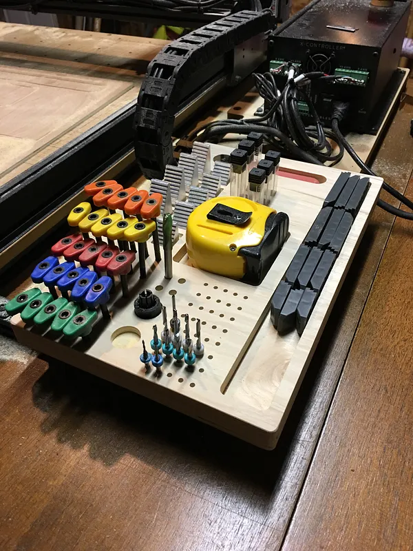

Store all your bits, clamps and clamp stands
cut into 1/2 birch with a 1/8 straight cut bit.
4 screws in the second panel and your in business in less than 1 hour!
x-carve 2016

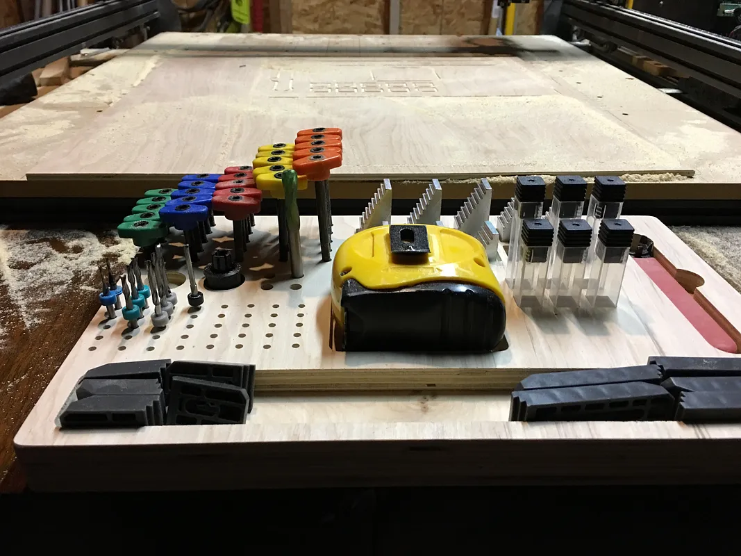

Tried to make this but your tabs are was to shallow. If your plywood is off a little it the cutouts will interfere with the bit. My project ruined at the point of the tap measure cut. The lug kicked out, hit the bit at pulled my wood from the clams.
