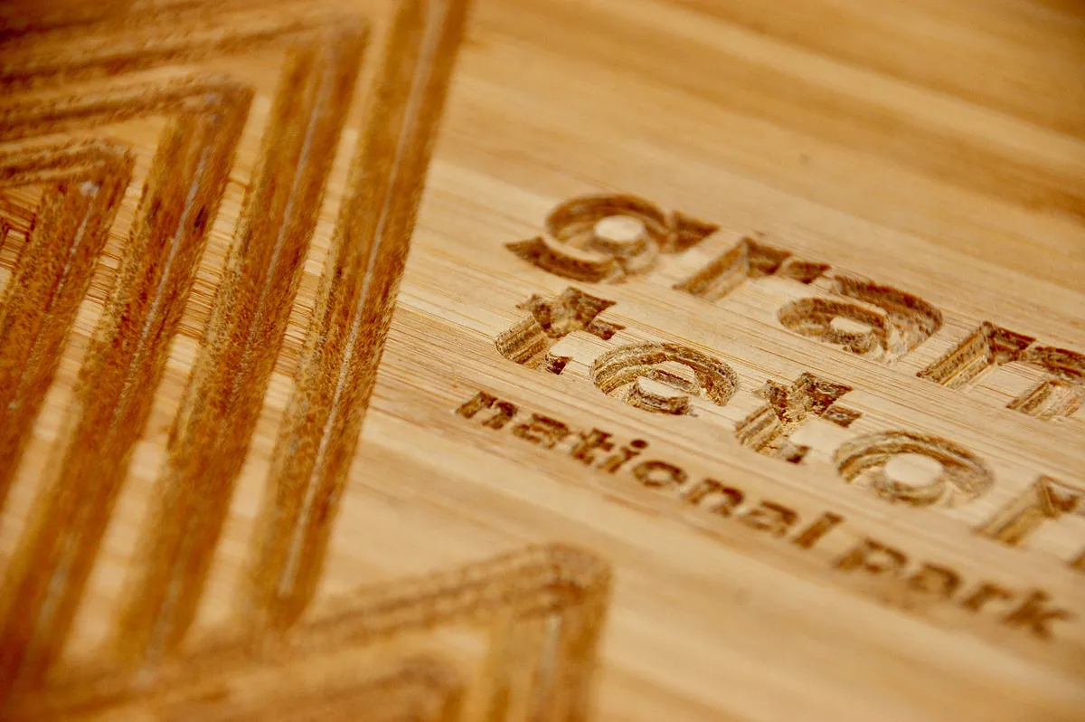

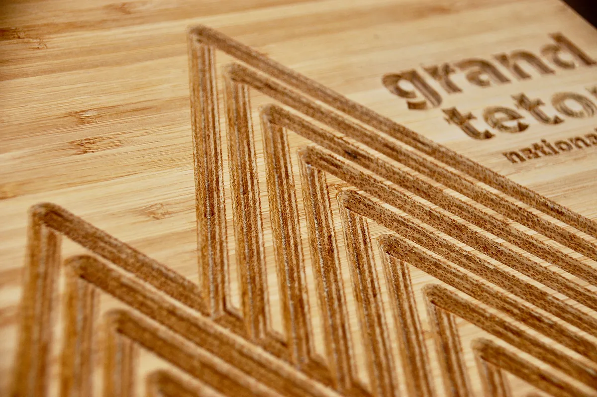

Mount Material, Insert Bit, and Carve!
This project utilizes a 90-degree v-bit on all its carving paths. You'll only need one 90-degree v-bit to carve the whole project file. Pretty rad!
Note: the design intentionally carves off the 12" x 12" workpiece so the bit's toolpath goes off the edge at the full depth instead of tapering upwards. Clamp wisely to account for these toolpaths!
