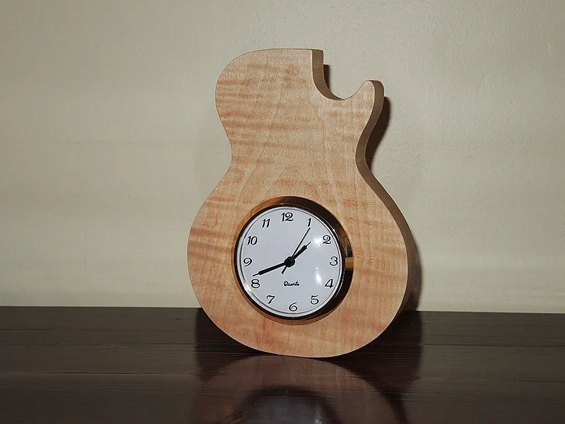

Purchase a Clock Insert
Purchase the clock insert prior to cutting this project. Below is a link to the clock insert that I used. It requires a recess that is 2.375" in diameter and about .6" deep. Adjust the diameter and cutting depth of the circle object in EASEL to fit your clock insert.

This project requires a through-cut, so I recommend placing a sacrificial board under the workpiece if you do not wish to cut into your waste board. Clamp the material down, check your settings, and carve your Guitar Clock!

John Tyrone, here. How do you change the circumference of circle for clock in Easel? I have the clock from Hobby Lobby but the cut out area is too large. Or can it be downloaded into V-cave Pro? tyty1936@yahoo.com
John Tyrone · August 02, 2018
@John Tyrone - You click on the circle and type in the new diameter and press Ente, then re-center it.
