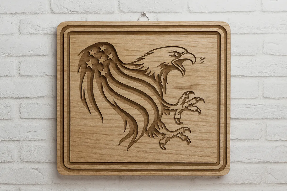

Crafted from cherry plywood, this features a stylized bold American eagle design. The stylized feathers flow into stripes accented with stars, symbolizing strength and patriotism. Perfect as wall art for your favorite patriot.

Was the carving just stained or painted? if painted, tell me the secret. How did you paint it. Taping something like this is too detailed for 80 yr old man. Suggestions. Thanks
Brent GaylerPro · October 30, 2026
The secret is a product called ORAMASK® 813. You CNC first, then paint, then peel the mask off.
