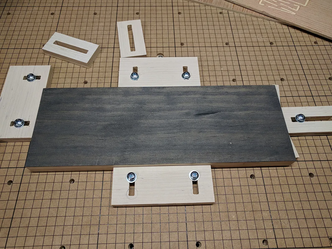

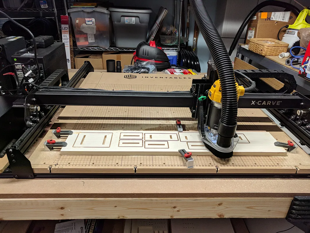

Remake of "Work piece hold down clamps"

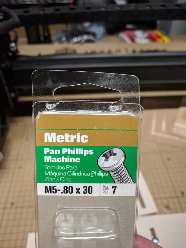

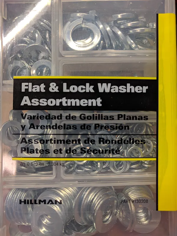

These are the same as Warren Downes project, just adjusted to fit a scrap piece of plywood (5in x 29in x .5in). These clamps hold firm, allowing the stock vac shoe to be all the way down on the project without having to worry about height. Also have pictures of the screws and washers used from L.
