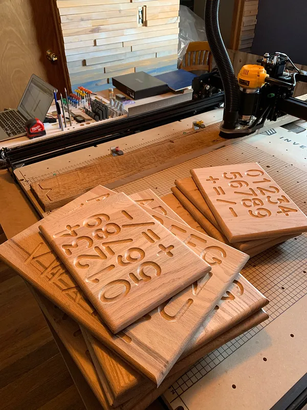

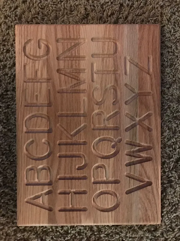

I buy Red Oak stair tread from home improvement center. Can get 3 full board and the cut off piece I cut width wise in half and make specific names on for friends or shapes and numbers for them the practice. This way there is no scrap.
NOTE: Use a good hardwood. The weight keeps the board from moving when they are practicing, it will hold up against wear and the carve come out clean. Also eliminate chance of splinters.
Round the edges over on router table
Make cuts and then simply sand and oil.

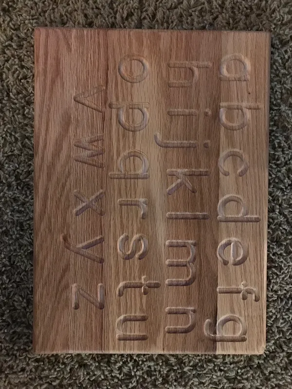

Cannot download the lowercase version I would love to have it.
Gerald Wojtanik · December 03, 2020
Cannot download the lowercase letter one I would love to have that one.
Gerald, I tested both and they seem to be working if you can send me your email i can send the SVG file. Inglestadt at gmail dot com
BRIAN RUSSELLPro · December 04, 2020
I would also love the lowercase and number version. When I download this, I only get the uppercase version. Any help you can give is appreciated! Thank you.
