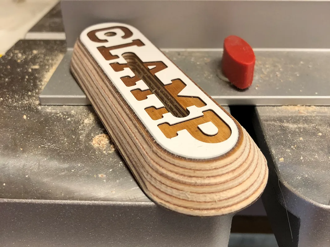

3d Clamp Multiple layout

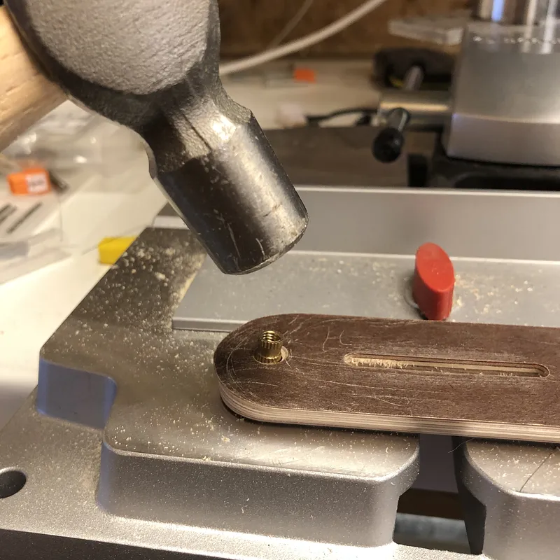

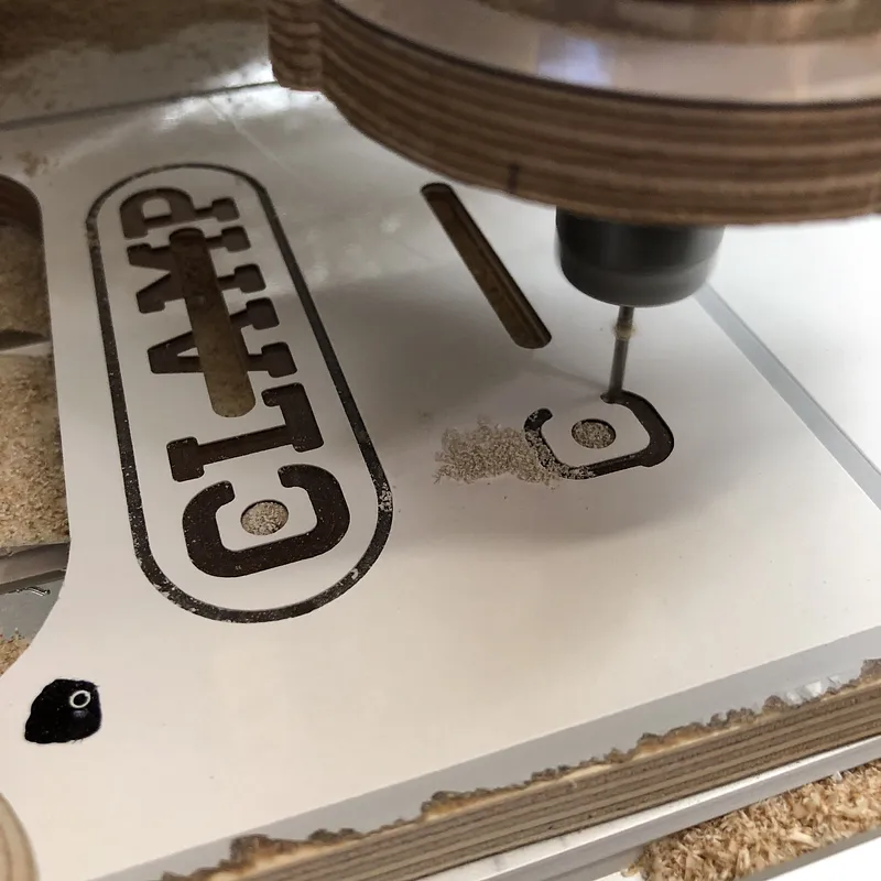

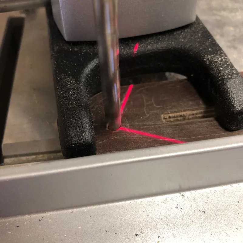

A "3d" carved clamp using only Easel and many layers. Drill a hole from the back and insert brass thread in the rear hole to adjust height at the back. I used 1.7mm 1flute straight bit and one tapered 2mm ball nose. Both set as straight bit in easel.
