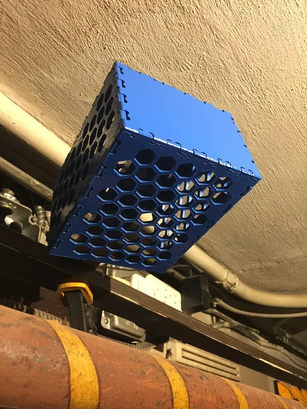

Load and cut. This takes a while to carve. I use bamboo as a material to get a decent feed rate. It could be faster. Anyway; this glues-with hot glue very strong; stronger than I expected. The dogbones work great. Hardboard easily allows for parts as this as 1/16", but you have to deal with spacing between the parts, and tabs. I could've used more tabs on this box to keep it stable.
I had a depth of cut problem in the beginning. I started out the code, but had a bad z-height. I killed the carve, re-homed, after checking depth and adding a few hundredths, and re-carved. I still have a low spot in the z on the right side of my table, but with the waste board getting whacked for about a 50th in the top left, and a little furry i the middle, I'm doing okay.
So I basically over-carve these types of shapes just to accommodate the wasteboard problems. I'll try to shim my next project to see if that help. It should.
