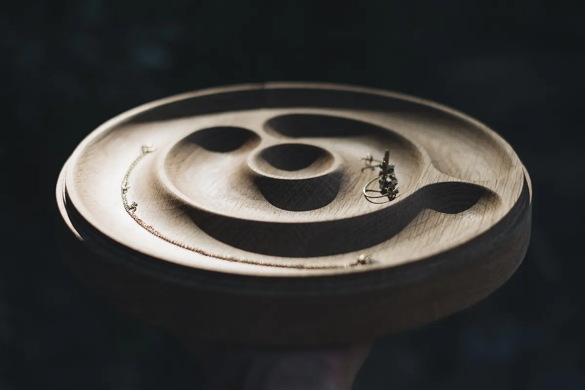

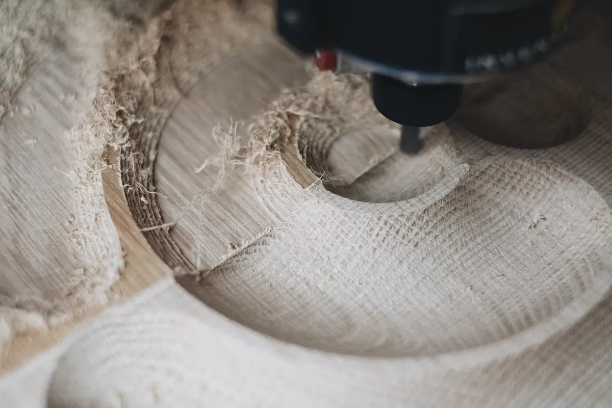

G-code is attached for you to load into Easel, or alternatively download the Fusion360 file to create your own toolpaths. One thing to note with the toolpaths I created - because of the thickness of timber I used (32mm) I wasn't able to cut all the way through with the 1/4 inch bit on the final cutting operation due to vibrations and bit deflection. I ended up going around 25mm deep and cutting the whole piece out of the stock with a jigsaw, and sanding/planing away the edge.

what bit setting did you tell easel when running the 6mm ballnose bit and how do you tell it, that is a cleanup pass?
Tammy RatzlaffPro · June 03, 2019
Hi Tammy - the whole project was made in Fusion360 so all the settings in Easel will be overwritten by the G-Code. Bit settings (feed/ramp speeds etc) are already in the G-code
