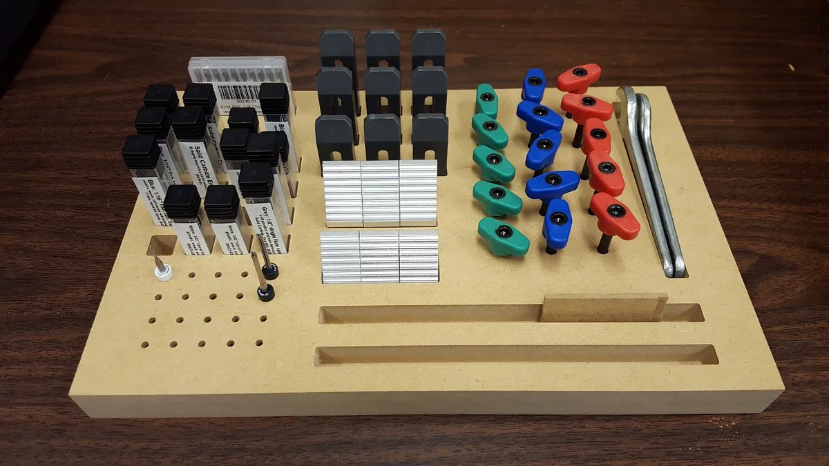

Organizer for Carvey parts. Made from 1" thick MDF. I let it run overnight and found that the bit had became hot and starting accumulating material. Maybe break into two runs giving the bit a clean in between if needed.
