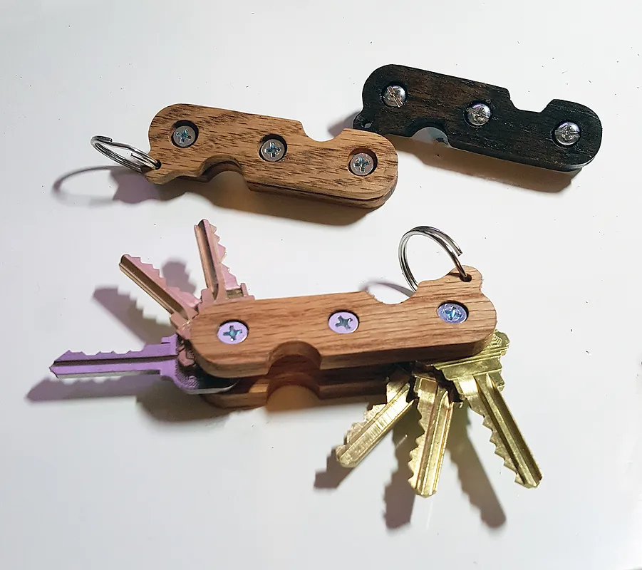

Materials Needed
What you'll need: • Hardwood, plywood, HDPE, or any other durable material that is 1/4" thick • Sand paper • Finish of your choice • 8/32 - 3/4" machine screws (longer if you need to carry a stupid amount of keys) • Split ring • Washers (if using less than 6 keys) • Keys
Carving and assembly Secure material to wasteboard Carve it Remove tabs and sand Add a protective finish Insert 8/32 - 3/4" machine screw then add 3 keys per side Secure with nut (if keys are too loose, tighten more and vs versa) Add middle screw and nut to keep keys from spinning Add split ring

Really like your design, definitely gonna have to make one. Just an idea here, have you thought about using sex bolts instead? You could then drop your material thickness as well to 1/8 or less. Also, maybe aluminum?
Thomas robin · May 21, 2017
The hard part is finding hardware that fits through the key's holes without modification. Most of those standoff style bolts are too large diameter for the keys. I'd really like that start making these on the Tormach I now have access too, but the xcarve should handle thin aluminum just fine too
Nicholas Zastrow · May 21, 2017

Can you make it without the middle screw so you could customized?
mark page · December 18, 2018
Yes and no. If you dont have that middle screw, the keys can rotate all the way through. It acts like a stop. I've been playing with the idea of getting rid of it and replacing it with a dowel or brass pin.
Nicholas Zastrow · December 18, 2018
