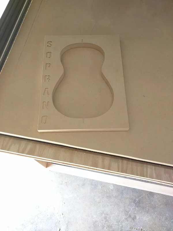

Soprano Ukulele Form
A simple form for building a soprano ukulele body.
Mill out of 3/4" MDF or ply. You'll need to glue 3 of these together to get the required depth to hold the sides after bending.
If desired, the same project could be used to cut out top, back and rosette.
Fretboard coming soon!

great job Dan!! aloha from Hawaii
