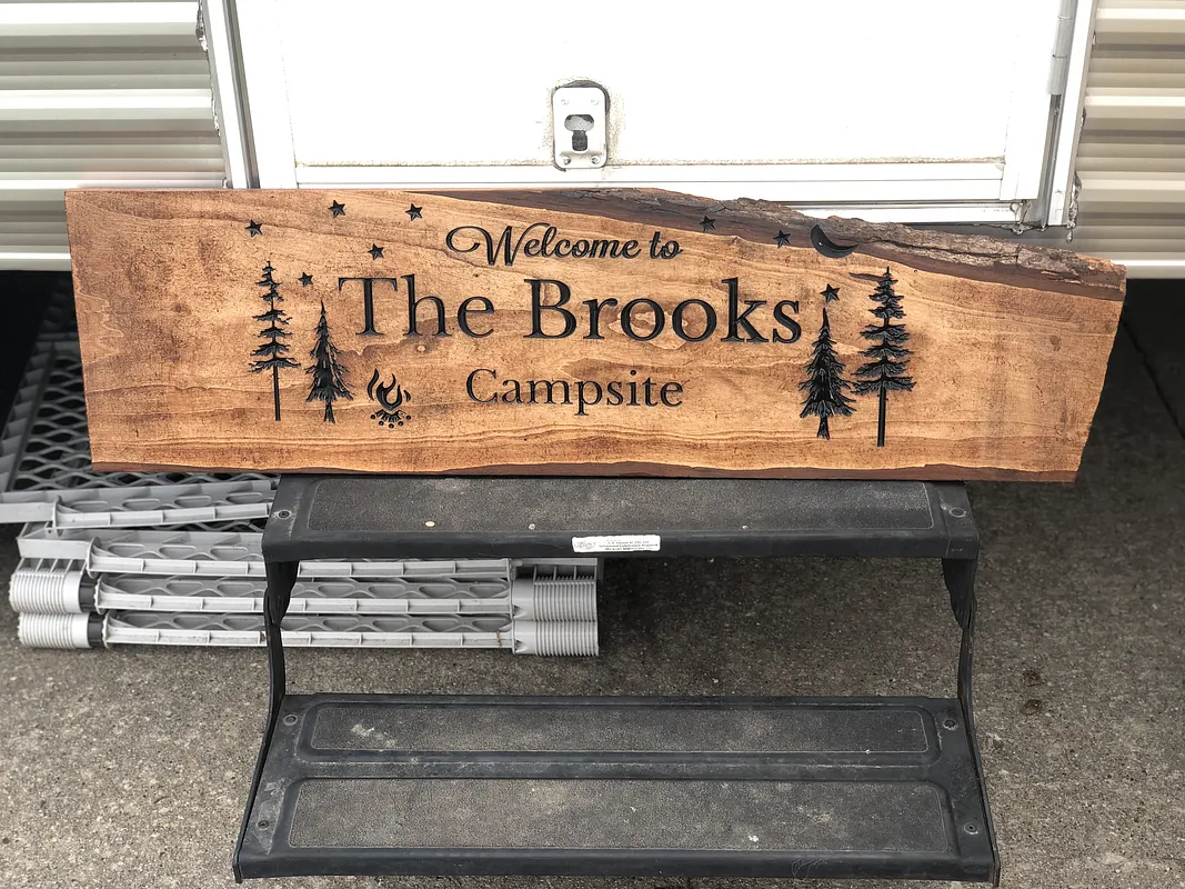

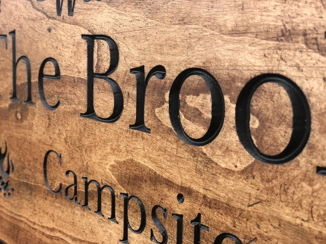

Camping season is HERE! These are pretty sweet and really easy to make. We use a 3/8 90* V-carve bit. Once it's carved I spray with spray paint and then plane the paint off the surface. When finished I stain and coat with a outdoor spray on poly.
Enjoy!
X-Carve
Hard Maple
