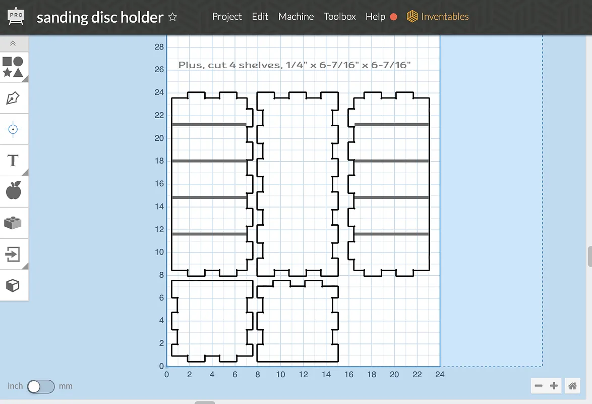

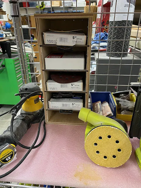

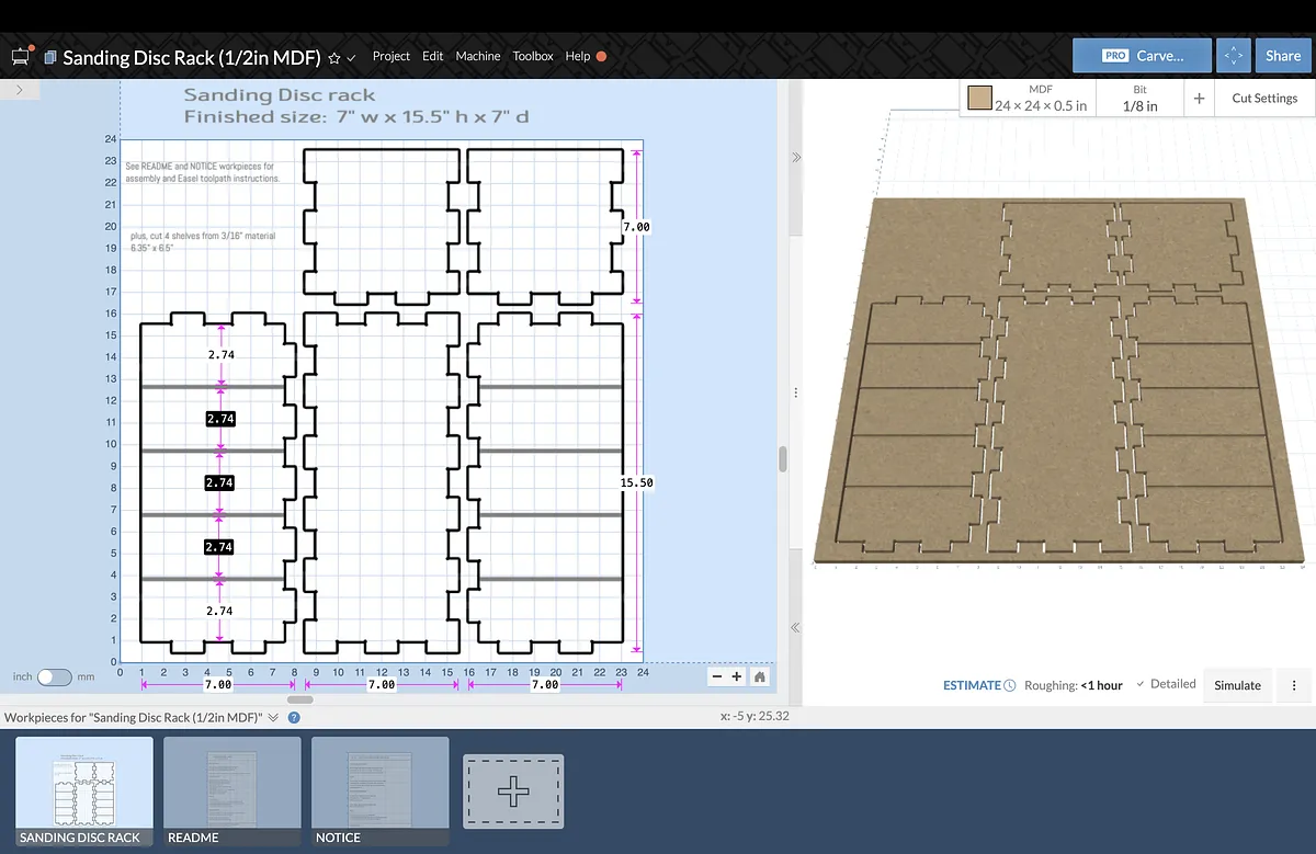

A compact CNC-cut organizer for 5" sanding discs. Made from either 1/2: MDF or 12mm plywood plus 3/16" shelves. Finger-jointed construction, strong and durable. Includes a README page, and a NOTICE about the Easel layering fix for proper shelf dado carving.
Notes
• Sized for 5" hook-and-loop sanding discs (Ryobi, DeWalt, Makita, etc.) • Shelves: 3/16" hardboard or whiteboard, • Works with 12mm Sande ply or 1/2" MDF. • More CNC shop-storage designs available at: https://www.etsy.com/shop/TahoeCNCDesigns
