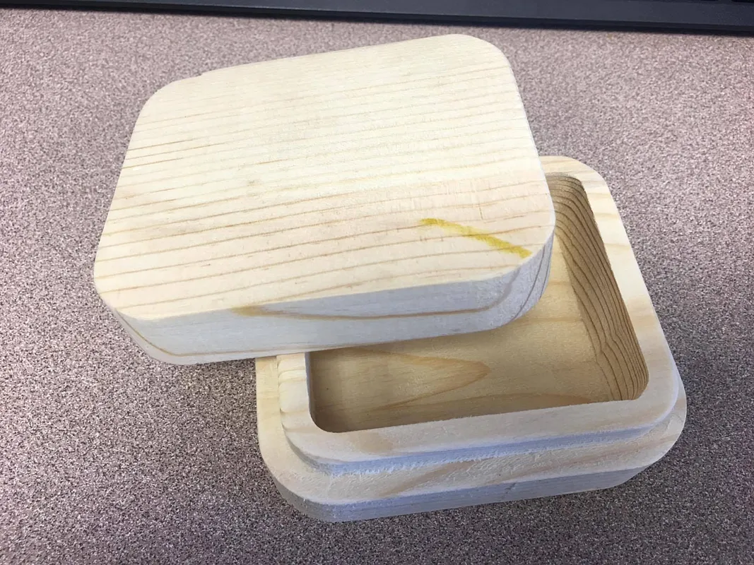

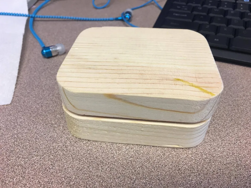

A box made from a 2x4 using a 1/4 router bit.
Recommended:
1. set depth per pass to be 20% of over all thickness of the wood.
2. make sure you zero x and y at low as possible on the piece of wood.
