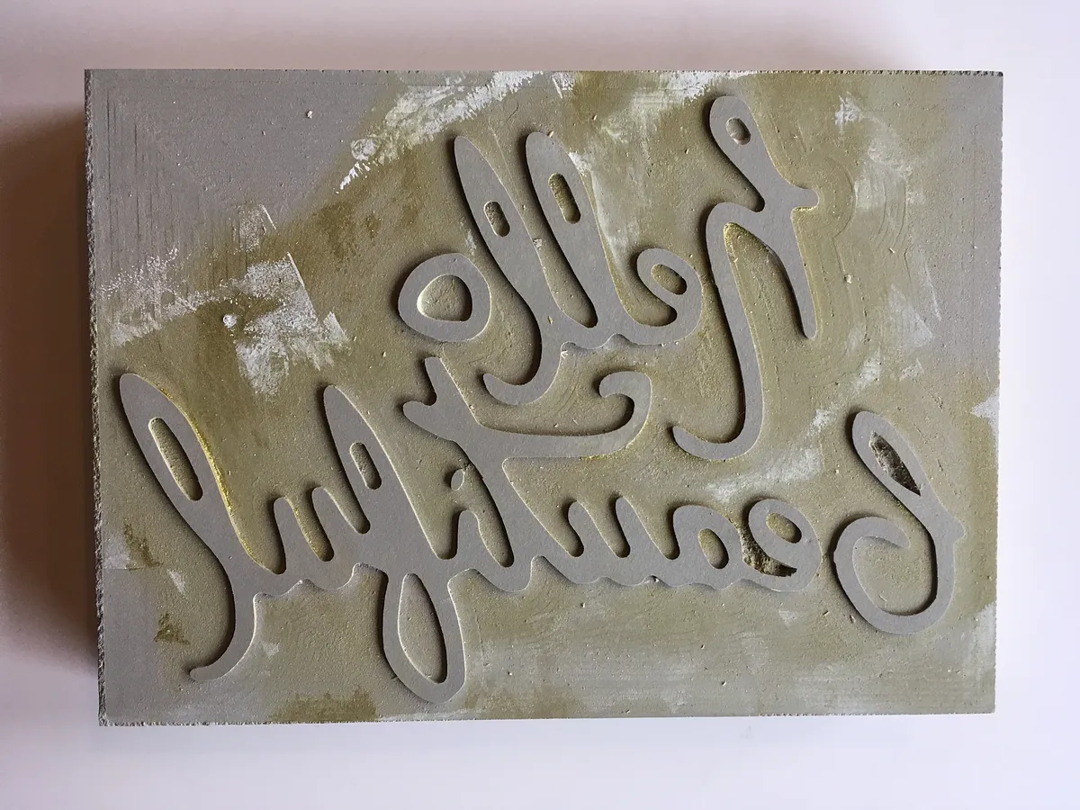

Carve into Linoleum
My design took about 20 minutes to carve, but carve time depends on the complexity of your design. You can make carving time shorter by trying using one bit (mine was all with 1/16" straight cut bit) and by keeping your design less complex. The larger the bit, the quicker your carves will be!
Estimated time: 20 minutes

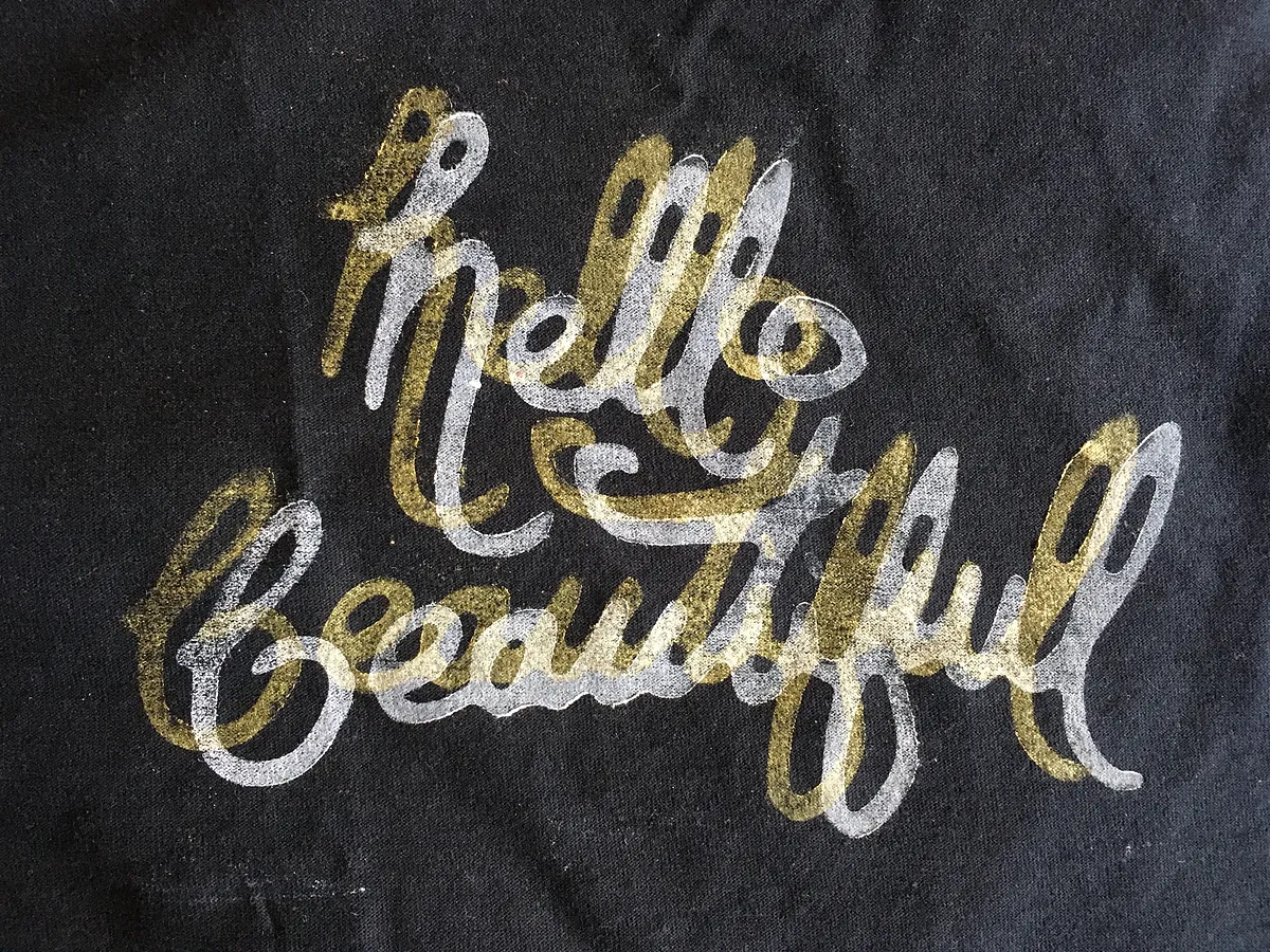

Stamp EVERYTHING
There are a lot of ways to use your stamp. You can use ink pads or tubes of ink with a roller.
I purchased Speedball fabric inks in multiple colors and used a roller to apply the ink to my stamp. If you're using the stamp multiple times for the same project like I did, make sure to clean the stamp and roller after each use. Water and a clean rag worked for me.
Go find everything and put a stamp on it.
