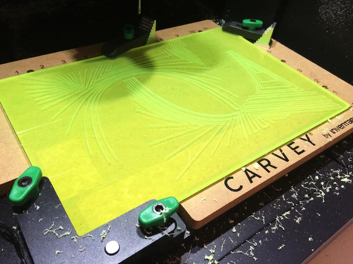

Secure the Material
Using double stick tape, securely attach your material to the wasteboard.
Estimated time: 5 minutes

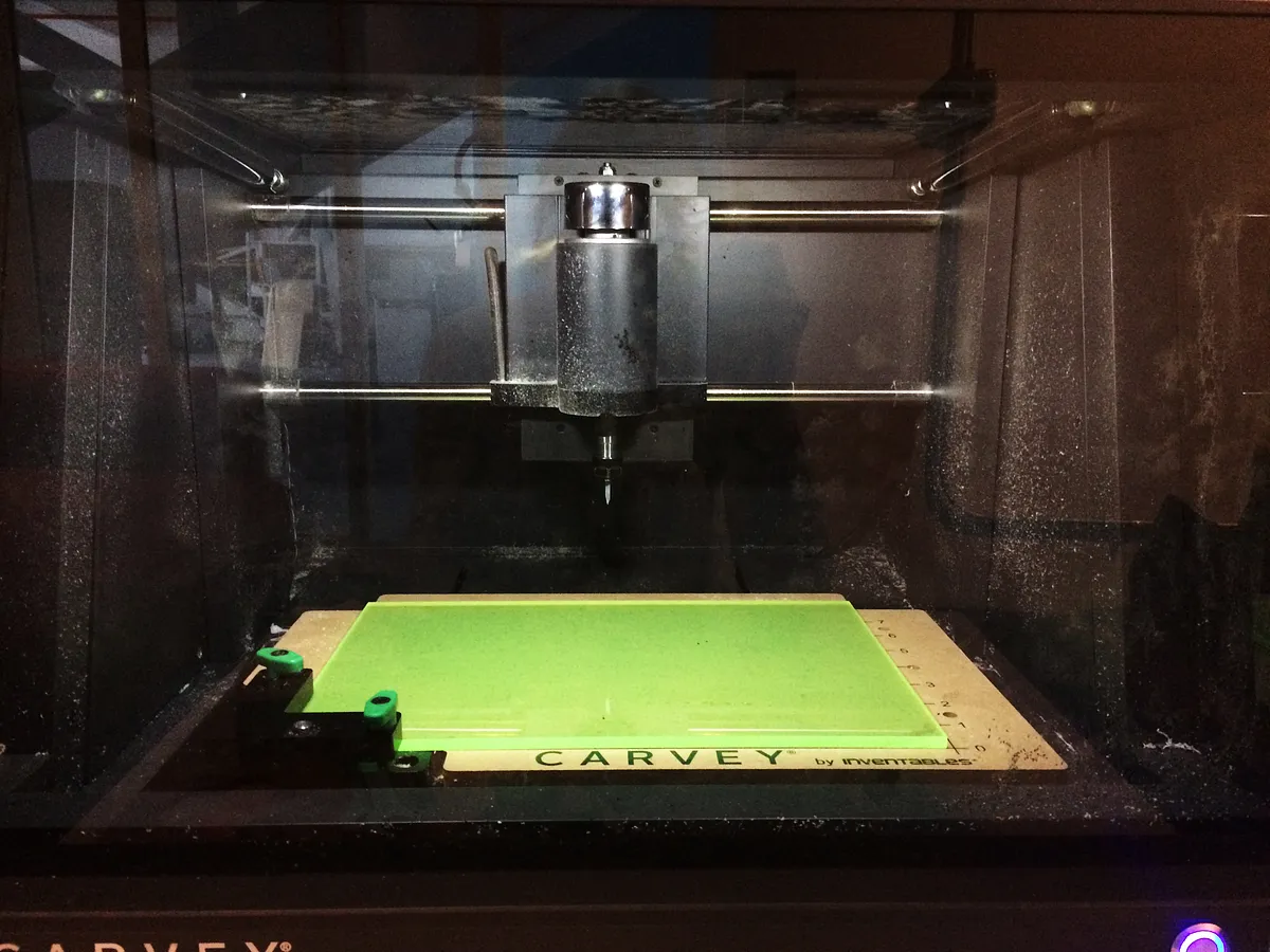

Engrave the planter
Set the size and thickness of your material.
The provided design is "located here":http://easel.inventables.com/projects/e8TKPIBXwVHyfJQFqd9-oQ, or use your custom engraving design in this step.
Use an engraving bit with the cut depth set to .01” and the 1/32 2FL Fish Tail bit. Carve the design.
Leave the material secured on the wasteboard for the next step.
Estimated time: 11 minutes

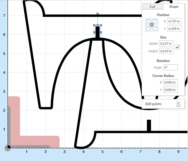

Adjust Connector Slots
Open "this Easel file":http://easel.inventables.com/projects/ohS95ndQBQF4OX82AthJ6A for the shape outlines.
The small rectangles (which are the connector slots) are set to a width of .25”. If your material is thinner than that (for example, .22”), the rectangle width should be changed to that measurement as well (or .003” smaller for a tighter fit). The width can be changed in the “shape” palette, make sure the center position is selected and that the lock next to width and hight is unlocked. Then type in the correct value.
Estimated time: 2 minutes

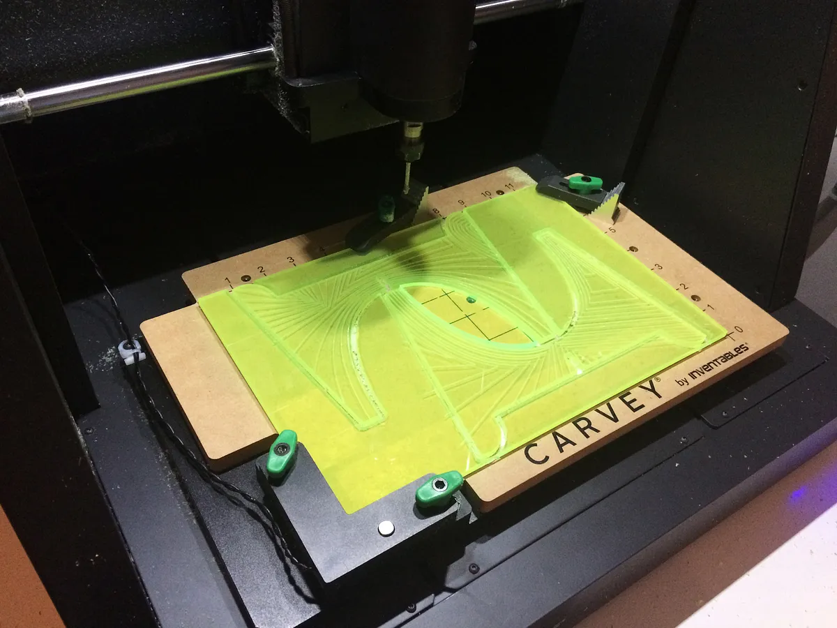

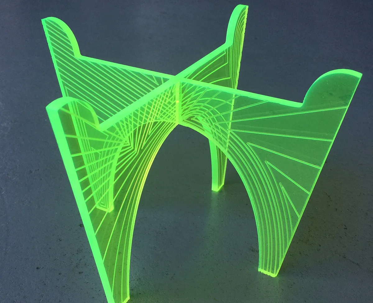

Cut out the pieces
Set the Z-value and cut depth to the thickness of your material.
Carve the planter pieces file from the previous step using a 1/8th bit. The 1FL straight bit (black ring) works well for acrylic.
Estimated time: 21 minutes

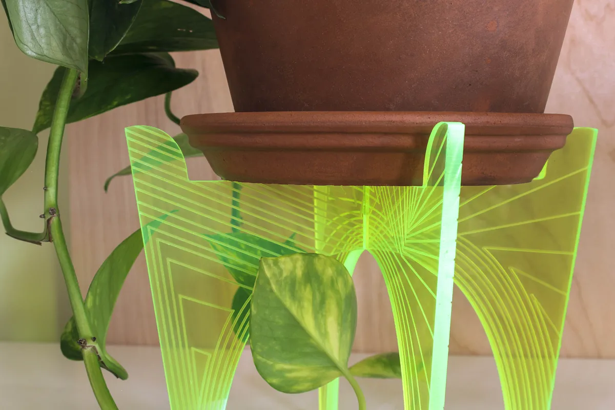

Assemble
Slide the 2 pieces together at the connection slots.
Estimated time: 1 minutes
