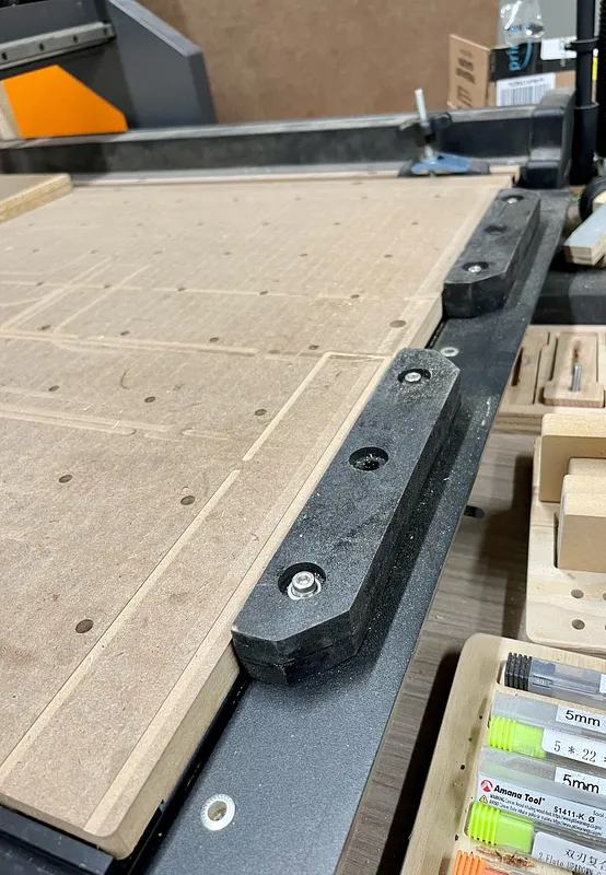

X-Carve Pro Front or Back Bumpers

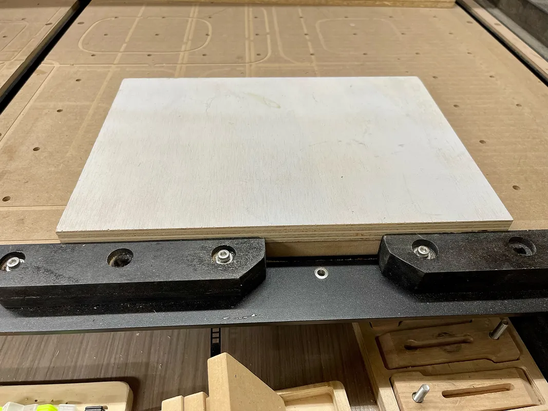

Put these on the front or back rails so your boards are flush with the waste board.
Glue the bottom and top pieces together to make a bumper.
What bit did you use
Robert ToledoPro · November 18, 2023
Either a 1/4 or a 5mm bit
